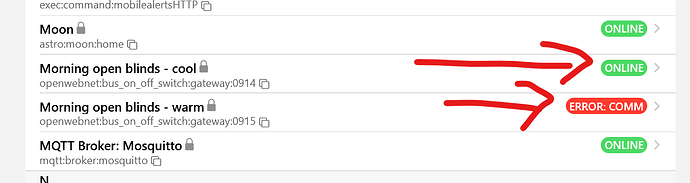

things
Thing bus_on_off_switch 0812 "Sunny cills1" [ where="0812" ] //No hardware
Thing bus_on_off_switch 0813 "Sunny cills2" [ where="0813" ] //No hardware
Thing bus_on_off_switch 0814 "Sunny cills3" [ where="0814" ] //No hardware
Thing bus_on_off_switch 0914 "Morning open blinds - cool" [ where="0914" ] //No hardware
Thing bus_on_off_switch 0915 "Morning open blinds - warm" [ where="0915" ] //No hardware

Not all addresses work the same. So you will need to test. I have raised this in the past but back then there was only me doing this and Massimo was busy enough. In my notes I have >>>>
//Thing bus_on_off_switch 29 “29 test” @“Test” [ where=“29” ] // No hardware. Doesnt work but addresses A8-A9 do without hardware. Sending command works for these in myHomesuite but address not found on a scan
