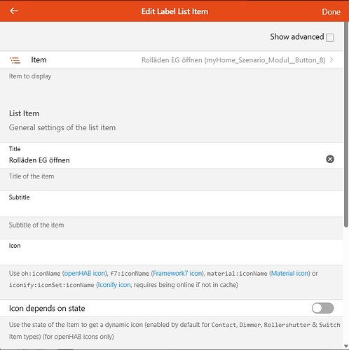

Hi there,
how can I trigger scenarios from the graphical UI?
just done it by files right now, but what I need to do in the UI?
Switch item=RollEGoeffnen label="Rolläden EG öffnen"  icon="movecontrol" mappings=[ON="Start"]
but when I do this, nothing happens.
Even by entering SHORT_PRESS or START_PRESS or Activate,..
What do I need to do to get a list where my Scenarios are listed and if they are pressed or a start button touched to make then work?
thanks in advance
kind regards
Christian
not sure but i suppose this may not be possible because cen are channels that need a rule to be started. as in the description of the binding shown you only can set a proxy item that triggers a rule, the proxy item then can be switched in the ui, at least this is the way i do it.
I’m doing this like shown here if it is file based and it works like a charm.
in items:
String          RollEGoeffnen                 "Rolläden EG öffnen"               <network>         (gSzenarien)                                         //   {channel="openwebnet:bus_cen_scenario_control:mybridge:99:button#8" }
in sitemap:
yes,you’re right
rule "Regel Rolläden EG öffnen"
    Item RollEGoeffnen received command
    val actions = getActions("openwebnet","openwebnet:bus_cen_scenario_control:mybridge:CEN_Control")
    actions.virtualPress("START_PRESS", 8)
there’s a rule :slight_smile:
But I can’t get it work if all is UI based without config files.
sorry i dont understand. now you have a textual config
  • perhaps a thing with your cen command (only needed when you want to listen to incoming cen command eg from a phys switch)
  • a switch item to send command ON
  • a dsl rule to proccess the on command from the switch to send a cen command to the bux
try to go step by step to see when it does not work. first remove the switch item from the textual config and create it in main-ui and see if it still works
then remove the code from rules dsl and create it in the main-ui. i cannot imagine why this could not work then but i never tried to create a rule in main-ui so i dont know. perhaps check a file created rule how it looks in main-ui to see how you have to set it up.
