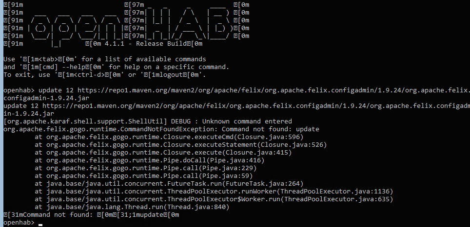

There is a quick test if the latest version of configuration admin shipped with Karaf is guilty of your trouble.
Just do
openhab> update 12 https://repo1.maven.org/maven2/org/apache/felix/org.apache.felix.configadmin/1.9.24/org.apache.felix.configadmin-1.9.24.jar
This command downgrades config admin to earlier version. After that do a restart of service and check if its any better.
The 12 in above command comes from this output:
openhab> la -s|grep 'org.apache.felix.configadmin'
 12 x Active    x  10 x 1.9.26                 x org.apache.felix.configadmin  // << 12 is module identifier
 15 x Active    x  11 x 1.2.6                  x org.apache.felix.configadmin.plugin.interpolation
Thank you for the help. But as mentioned above, I am on windows :-).
Where should I put this - on thecomand line? There is a update script, but afaik its only to update to other OH version? So it throws an error:
I found a shell.bat that startet something… but was not lucky with the comand
I cant do this in the OH console because its not running because this is the error I want to fix I thought? :face_with_raised_eyebrow:

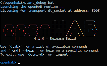

I added the logging to the log4j2.xml, but the output in start_debug seems not to change?
C:\openhab2>start_debug.bat
Launching the openHAB runtime...
Listening for transport dt_socket at address: 5005
14:17:54.819 [Start Level: Equinox Container: d32e8287-527b-48a3-a7a8-aeab3a8bc2f6] ERROR org.apache.felix.configadmin - Failure setting up dynamic configuration bindings

I delete cache folder and start (either start_debug or start via service) and then I see this beeing created in cache:
and this on the console/ wrapper.log:
when I try to access console I get this.
The shell comand works somehow. But I always get that error “unknown command entered”:
