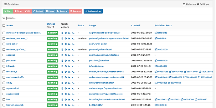

My list of containers in Portainer
That’s a lot of software with conflicting requirements, and I think it’d be really hard to keep it all running happily using just SystemD. This is where Docker really shines!
I strongly recommend Portainer to keep track of your Docker containers. While you can theoretically do everything you need from the command line, I find it very helpful to view everything at a glance and make small changes. I would make getting that set up the first step of a successful Docker setup.
