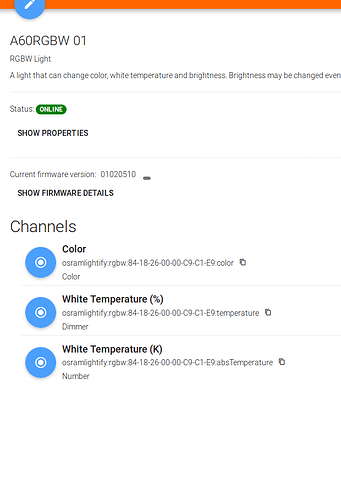

Channels ‘power’ and ‘dimmer’ are not showing up on Thing configuration page of light bulb. Only channels ‘color’, ‘temperature’ and ‘absTemperature’ are displayed (see screenshot below).
When I open Thing configuration page of my light bulb, in the right lower corner "ERROR: 404 - Not Found " is shown for a few seconds. But I can link items to the missing channels and use the items without any problems:
Switch light_power        "Licht Flur: Power"     <light> {channel="osramlightify:rgbw:84-18-26-00-00-C9:power"}
Dimmer light_dimmer       "Licht Flur: Dimmer"    <light> {channel="osramlightify:rgbw:84-18-26-00-00-C9:dimmer"}
Maybe its just an issue with the configuration page.
Thanks for this nice plugin!
That’s correct. If you have an RGBW device you have a color channel which supports dimmers and switches so separate channels aren’t required. Those channels come into their own for tunable and plain switchable devices though.
That said, the device handler cares more about the type of a command rather than the channel it was sent to and nothing stops you having a text configuration that sends commands in via bogus “channels”.
