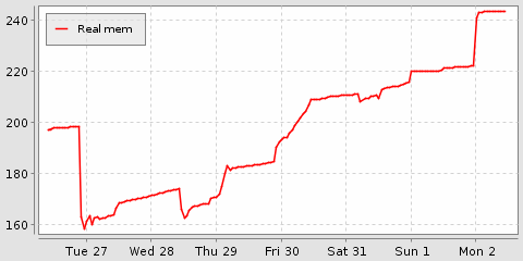

My server has currently been up for 5 days since the last time I restarted it. I do see memory increasing slightly over the week but nothing like you are describing. I think the recent 20 MB memory jump may have been because I added the MQTT binding and set up event bus publishing to experiment with external rule engines.

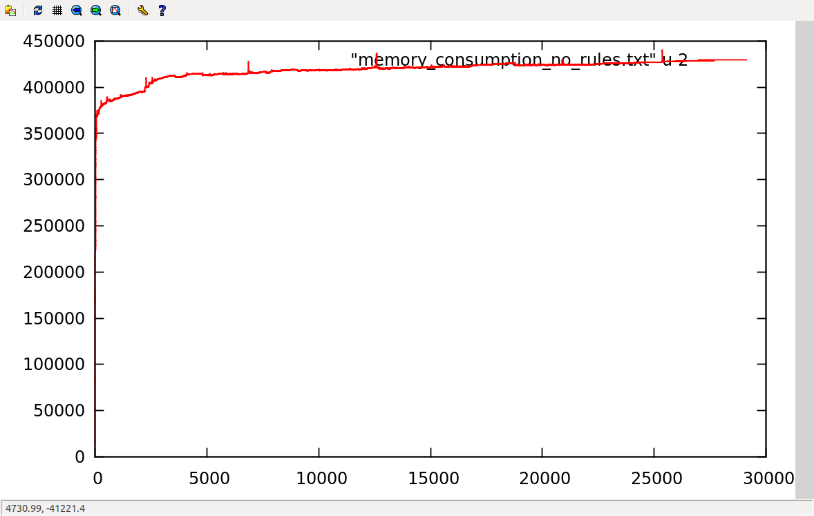

This is what the resident size (in kilobytes) looks like as a function of time (in seconds), without any python rules running, but with the jsr binding in the addons folder. Ugh.
How can I find out where the memory goes? jvisualvm didn’t give me any clue what’s going on. Are there any other debugging methods? I am running with -Xmx256m -Xms256m. If the memory leak was a regular leak in the openhab java code, shouldn’t that terminate the process well before it reaches a GB of resident size?
