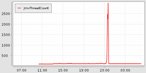

Given the warnings I see around each memory incident about Upnp being unable to create native threads, I think the following chart of the number of active threads is interesting. Normally there are about 100 threads running, but that spiked to about 3000 threads right at the time of the OutOfMemoryError and then quickly dropped again to normal.
The 3000 threads could easily account for the spike in the virtual memory usage. I’m going to continue to monitor the situation, but I’m increasingly thinking that the Sonos binding is the culprit.
