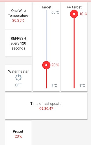

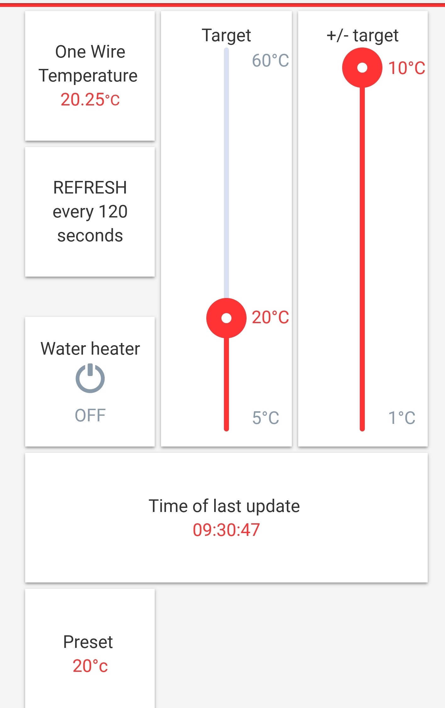

I’ve tried one of these ready made One-Wire Temperature sensors as a solution for a client that wanted to measure his hot water tank.
eBay One-Wire passive temperature sensor Item Number 230962285627
As it’s a Passive One-Wire device (rather than Master & Slaves), I simply use a polled exec command like
digitemp with an edited configuration to only return the temperature (rather than sensor ID & Time & Temperature with symbol etc)
It works really well.
