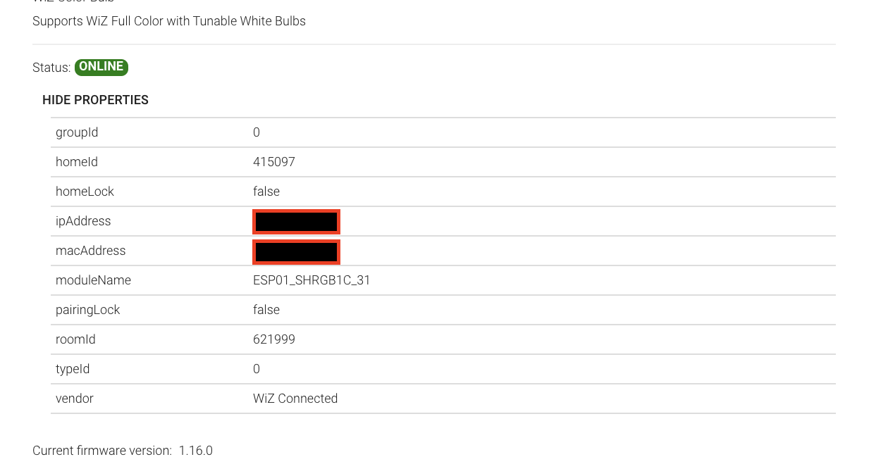

Do you have full color bulbs, tunable white, or dimmable ones? I only have the full color ones, so that’s all it has been tested on. If you have any others, I would really particularly appreciate it if you could go to “Show Properties” when editing the bulb in PaperUI and tell me the moduleName that appears.
Ive got the color/ tunable white Recessed lighting bulbs from Home Depo. After I sent you the original message I threw the .jar in that directory thinking maybe it was that easy but then I had to move on to something else and forgot about it. The next day i went into open hab and noticed my 2 wiz devices ready to be discovered! At first glance the worked great, i didn’t have any trouble getting them to connect but i soon I noticed i could only truly control the white color (warm and cool) and brightness functionality. when id try to control colors i could get a reddish color but thats about it. This worked about 2 days then a few nights ago I noticed the weren’t responding anymore. I checked through amazon (via wiz skill) and through wiz app directly, and they were controllable there.
Also, i realized late on that I was now possibly sending commands to the lights twice, once through alexa via wiz skill, and also through Alexa via openhab skill, so maybe that did something I don’t know.
At this point, they are controllable through the wiz app but i disabled wiz skill, and re-added the lights on openhab but have not been able to control them on openhab anymore. Still, it was exciting to have all my house lights finally working together for the last few days. Hope the properties info help you out. I included a screenshot of the properties info for you. If you have any suggestion for what may have happened to stop them from working, id be happy to give it a try.
Screen Shot 2020-01-12 at 8.39.32 PM
Well, I rebooted openhab, re added the lights and it seems they are working again. :slight_smile:
To clarify, the white works and is tunable from warm to cool
colors still dont work, when i move the color on control, i see 400- bad request at bottom and can only see red color on lights.
Yes, I can’t quite seem to get the colors right. I thought I had it working, but it’s not quite right (except for red).
The color input for them is different from any others I’ve found in openhab (or Google) because there are 5 colors of led (rgb plus warm white plus cool white) and they’re all controlled independently and then the dimming is yet another channel. Essentially all the examples I’ve seen have only 3 channels (rgb, hsb=hsv, hsi, or xyz). These have 6. I’m trying to replicate the way the app sets the colors, but I can’t quite get it right.I’ve been playing with it this weekend, I’ll post the latest version, but it still isn’t perfect.
Here’s a link to the latest jar: https://drive.google.com/open?id=1-4Zqw6-s5GZfYuSDxp1KusQTHJ7JUMCC
With this I can get the light to be any color at 100% saturation, but as soon as you touch the saturation it might revert to a very slightly tinted white. I also added a separate channel for the brightness, so you can control the brightness either along with color in the color picker, or by itself just as brightness. I did that because the bulb operates in either color mode or temperature mode and without brightness in a separate channel you would couldn’t change the brightness while in temperature mode.
To get the new channel you have to delete and re-add the things. If you don’t delete your channel links and items, hopefully they’ll re-link themselves as soon as you re-add the things.
