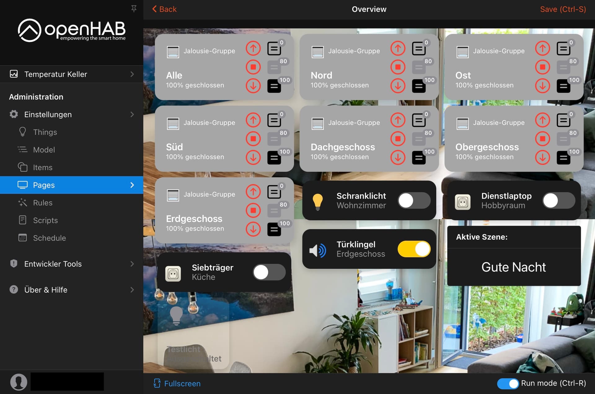

A little bit embarrassing but: how can I set a responsive background image for the whole custom overview page? Appearance should be as on the homekit app from iOS. On phones just a portrait part and on bigger screens a landscape part of the image.
Is it by defining a background style property of the root component of the overview page? I tried it but the background keeps black.

Hm, it is partially working. But I still need your help. When I am in the settings area and in the „run mode“ with CTRL + R I can see a background picture.
When I am on the standard overview page I only see a black background again. In the run mode the background-attachment: fixed property does also not work correctly. I would expect a background image being fixed while scrolling over the content. However, the image scrolls with the content and is being repeated until the end of the page.

The result (btw. I am currently just fooling around. This page is of course not my final one. Will it be ever finished? ^^)

So, I shortened the URL but I still have the same symptoms. Looking at the code it appears as if the background property is only used in the design area of openhab and on the real overview page it gets completely thrown away. But at least the background-attachment: fixed property is now working as expected when I can see the image in the design area. When I am scrolling the widgets move but the background stays fixed. Yeah. :slight_smile:
