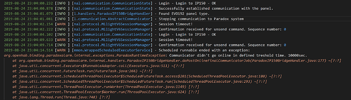

After one day of working it has stoppend and I have this error message repeated in the log file:
paradox new binding.log (8.0 KB)
Unfortunatelly I have 10 log files, and problem was started somwhen yesterday night, but beginning of the problem has dissapeared. If needed, than I reset the binding and try to catch it.
So just to summarize:
  • You managed to run the new binding successfully now and it ran for ~1 day.
  • The log files are capture with new binding and socket timeout occurs. This is probably why the binding disconnects also on my system from time to time. I need to implement a simple reconnect functionality. Will put that in my backlog.

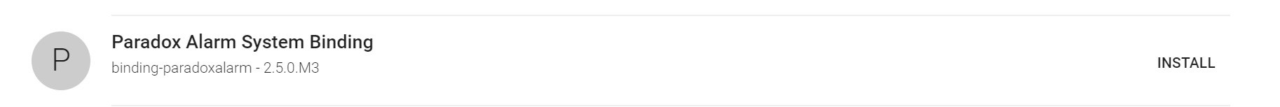

I’ve just checked the binding list:
It seems that this binding is included in 2.5.0M3. Whitch version is it? I won’t uninstall the new snapshot now. Let’s see the stability first, Than I try to swap to the built in version, if it is the same.
The built in addon version in 2.5.0.M3 is the one without the fix I’m mentioning about, but all in all it should be working just fine with exception that in certain cases when there is live event in the response from Paradox it will lead to an exception in the scheduled task that polls on every 5 seconds. This results in ending the scheduled task and the workaround is to do a reset on the communicator part which reconnects and reinitiates the scheduled task. I hope that I fixed that in the custom .jar.
If the fix I provided here as a binary in the .jar is OK I will probably create a PR which should be included in M4 if all wents good.
