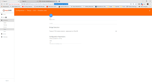

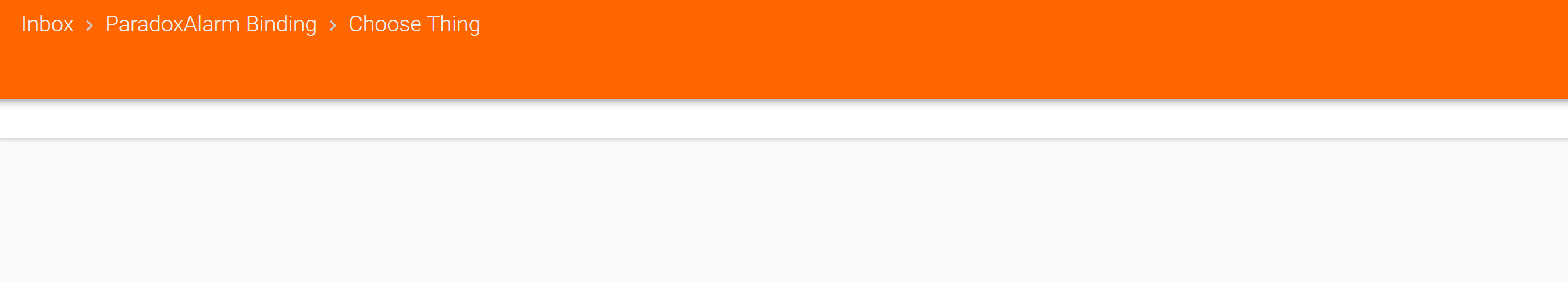

Add Zone through PaperUI selecting IP150 bridge and add zone#:
Copy selected part of the link in the browser and delete zone in PaperUI:

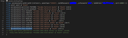

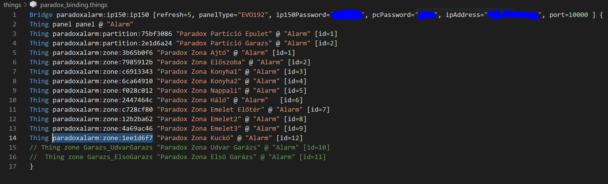

Create zone in the .things file and save:

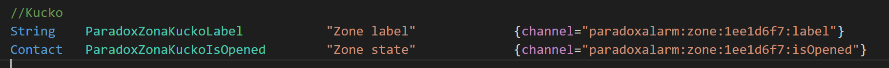

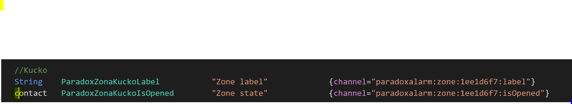

Create Items in .items file, change contact to Contact and save items file:
It should looks like this:

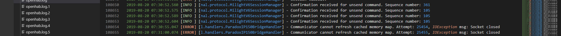

I have this error message about in every 5 sec in openhab.log.
Everything works fine, I just wanted to give information. Probably it is normal.
do the zones/partitions update normally?
If yes, this means that there is some issue with lifecycle of handlers. A restart of OpenHAB should fix this issue.
If they do not update for some period I would advise you to do the reset of binding using the command LOGOUT/LOGIN.
Socket closed means that the communicator’s socket to the Paradox system is down. I need to look into this and maybe do a remediation, i.e. a reset or something. If there are two bridge handlers active in the system though I can’t do much. Only a reset of the openhab will fix the problem.

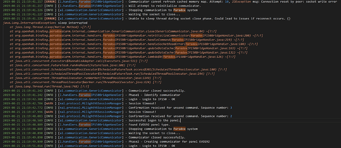

After certain time of messages, it seems that it restarts itself:
Hm… this stack trace is not from latest binding version. Actually it is from version before the real refactoring occurred. I just checked into the code we don’t have anywhere anymore Thread.sleep() because this was one of the major issues I had to solve.
Are you sure that you use the latest .jar, i.e. org.openhab.binding.paradoxalarm-2.5.0-SNAPSHOT.jar and not the org.openhab.binding.paradoxalarm-2.5.0-OLD.jar?
I’m afraid that these logs appear to be for much older release…
