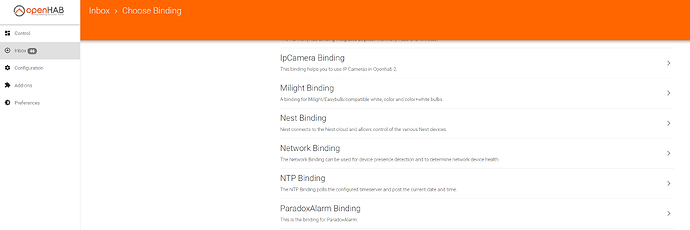

i downloaded it in the addons folder check the image
i am not sure what i am doing wrong but it is not in my binding list
When you copy it into the openhab/addons folder after a few minutes you need to see the binding in configuration bindings menu, plus inbox add menu as well. or, check openhab.log in User/Log folder and you need to see error message of binding installation.
hi, my jar file was corrupted. i deleted it and download it again. now it shows up.
