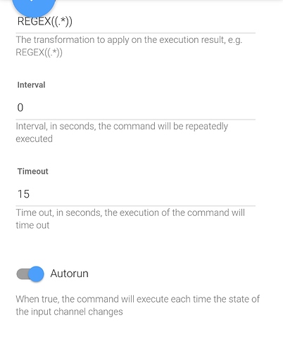

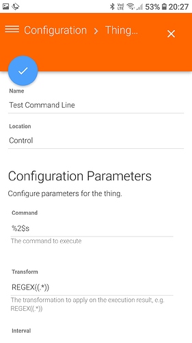

I want to run a php script which hand over a parameter. I hoped to use “things”, “items” and “sitemaps” in such a way that in things I would define the hand over parameter as %2$s in things and either in items or in sitemaps I would define this parameter to receive the status of an item (in this case a temperature).

All I can tell you is that I harvest a value from a single OneWire sensor using a digitemp command in an Exec Binding Thing, and link the output to a string Item.
There is absolutely nothing preventing you from continuing to use the Exec1 binding.
You can’t link the same Item to both the Input and the Output Channel of the Thing. You need one Item linked to the input channel. Anything that Item gets set to will replace the %2$s in the command. The result from calling the script will be set to a separate Item linked to the Output Channel.
The interval and autorun parameters can only be defined on the Thing. You cannot define them on the link in the Item.
Then you must write Rules to pass these parameters to the Item linked to the Input channel. This will kick off the script and the result will be set to the Item linked to the Output Channel.
