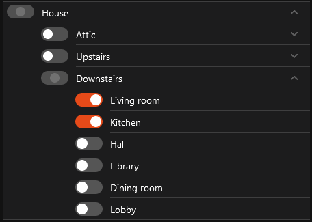

Awesome! Again Justin, many thanks. I am learning fast but this would be so much harder without your valuable input. I hadn’t spotted from the docs that you can just style a regular component but not one made up of a custom widget.
I scratched my head for a second or two because I have lots of style properties in the custom widget relating to the f7 block that contains its components, some of which are calculated CSS variables, but I need to pass two from the parent widget. I can do that by using
  style:
    position: absolute
    left: =props.style.left
    top: =props.style.top
    --widgetHeight: calc(var(--widgetWidth) / var(--widthHeightRatio))
    etc
The combination of my accordion list toggle widget incorporating my 3-way toggles now looks like this, which is exactly what I was going for. Many many thanks.
