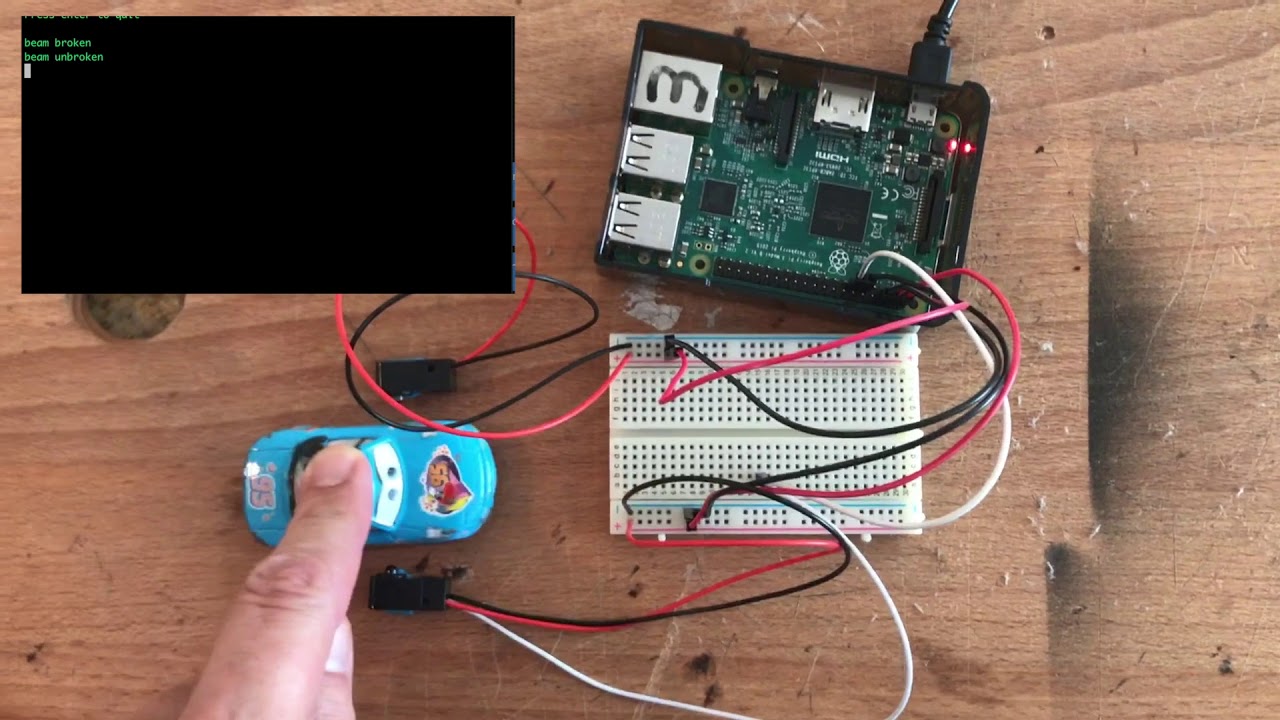

Instead of a PIR at the door why not use a break beam switch.They can turn lights on as you enter room and off as you leave. Or place it on your desk, seating area etc. You could make one using RPi
eg

re: beam sensor - that’s an interesting sensor I hadn’t thought of. The advantage of the PIR is its it’s such a cheap self contained little package using 2xAAA - broadcasting 433MHz coupled with a Sonoff bridge. I figure the AAA is going to last ages as the 433MHz must be a lot less power hungry than a device connected to wifi. Will keep it in mind though. Connecting it to an ESPY would be even better - a Pi is a huge amount of compute for a simple beam sensor.

re Pi… its just an example and I thought maybe you have OH already running on a pi. There are other complete break beam sensors available eg using wireless to an alarm unit. You need to google what’s available and see if any fit better with your situation.
