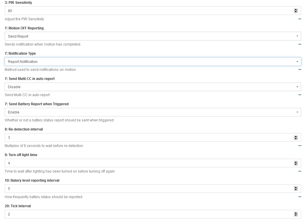

Hi all,
I encounter the same problem as you. My Philio sensor PSP05 has been discovered on Paper UI and the channels sensor_binary, alarm_burglar & battery-level are linked to items. When a motion is detected, there is no event in OpenHab. However, sometimes Openhab receives events (see events.log file and corresponding openhab.log file)… maybe due to wake up message ?
I don’t understand the problem. @chris Can you help us ?
events.log

@johnb Your log doesn’t show a command being received about motion being detected. Do you know if the association group is configured for the device? (i.e. telling the device to send motion events to OpenHAB)
@nokyyz What do you mean by ‘there is no event in OpenHab?’ The Detector52_Movement changed message in events.log suggest its all working.
In my openhab.log i only got 2 entries from the Motion Sensor:
2018-01-08 21:42:22.114 [me.event.ThingUpdatedEvent] - Thing ‘zwave:device:Razberry2:node22’ has been updated.
2018-01-08 21:42:22.305 [vent.ItemStateChangedEvent] - g_te_bs_motion changed from 0 to 1
2018-01-08 21:42:47.168 [me.event.ThingUpdatedEvent] - Thing ‘zwave:device:Razberry2:node22’ has been updated.
Maybe i push the trigger on the backside.
The Motion state switches to “1” but don’t came back to “0”.
..waiting 30 min… but no change of state and no more entries in the openhab.log
My configuration:
How could i get more information from the Motion Senor / Openhab?
Hi Alex,
The device information for the Philio PSP05 shows there’s no association group configured for the device.
Can I setup an association group or does the device database need to be updated? Sorry for the newbie questions.
Thanks,
John B
@Marcello87 Your screenshot suggests you’ve enabled the required option (Motion OFF Reporting). Have you tried waking up the device a few times? (and is ‘Send Report’ still showing as the selected option on that page?)
@johnb The database appears to be incorrect. According to the manual it has two association groups. You should have group 1 set to your controller, though if OpenHAB doesn’t know about the groups, I don’t know how you’d do this. Do you have HABmin installed?

Hi John
I managed to get my PSP05 to work!
In HABmin I changed the ITEM 7 “Notification Type” to BINARY.
It is at little tricky to save the value due to the battery powered PSP05 ! :wink:
  1. change the value in HABmin (dont save!)
  2. push the little thing on the backside of the PSP05
  3. instantly save in HABmin
    4 push the little thing on the backside of the PSP05 again
  4. Hope for the best and check after a couple of minutes.

Hi Alex,
yes and “Send Report” seems to be fix, it don’t change.
@Michael60: I’ve tried your solution but on the first and second try it don’t save the setting. I will try it again.
How long takes on your setting to save the new configuration, and how near you stood to the zwave controller?

Hi all,
I succeeded in configuring my PSP05 sensors to detect motions ! :slight_smile:
To configure the parameter n°7 to “Binary” value, I have used another Zwave software: Home assistant. I have set the “Customer function switch” (parameter 7) to 22 value according to OZW recommandations.
For information, the documentation of this parameter in Home Assistant is:
Customer function switch, using bit control.
Bit 0: Reserve.
Bit 1: Enable sending motion OFF report (0:Disable, 1:Enable). Note: Depends on the Bit4, 0: Report Notification CC, Type: 0x07, Event: 0xFE 1: Sensor Binary Report, Type: 0x0C, Value: 0x00.
Bit 2: Enable PIR super sensitivity mode (0:Disable, 1:Enable).
Bit 3: Reserve.
Bit 4: Notification Type (0: Notification Report, 1: Sensor Binary Report).
Bit 5: Disable Multi CC in auto report (1:Disable, 0:Enable).
Bit 6: Disable to report battery state when the device triggered (1:Disable, 0:Enable)
Bit 7: Reserve.
ozw recommended setting: 00010110 : 22
