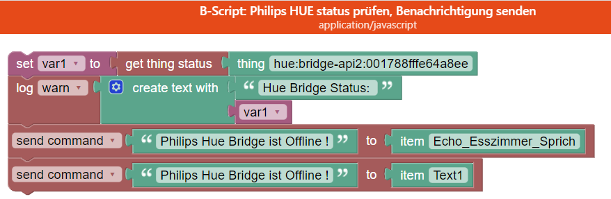

With the upgrade to OH4 I also upgraded to Hue API v2. With the API v1 I never had problems but with the API v2 the hue bridge went OFFLINE from time to time. Therefore I created a small script
image which send a message when the status of the hue bridge changes
 but I couldn’t find an OH function to DISABLE and ENABLE the hue bridge, which will solve the problem.
Attached find the hue messages from the LOG:
