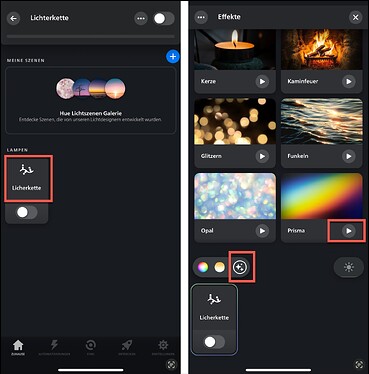

I bought that new Hue string-lights “Festavia”.
There are a couple of effects available, e.g.: candle, sparkle, fire, prism.
Most of the effects are recognized by the binding, but prism isn’t.
Is there a way to add the prism effect as well?
When changing in HUE App from fire effect to prism effect, the OH logs just shows “no_effect” → last row of the log:

I suppose Prism is either a “timed effect” or a “smart scene”?
https://github.com/openhab/openhab-addons/pulls?q=is%3Aopen+is%3Apr+hue
I guess it is timed effect:
prism
Ok. So it should be supported in the official binding as soon as those changes have been merged. Or you can manually install the jars from here
just FYI: the jar does not support/solve it.
(tested with OH4.1.0M1 with binding from Add-on store and testedt with manual installed jar file).
Hmm. I must be honest that I wrote the timed effect code based on the API specification but without having my own actual device to test it. So perhaps you can help me to get this right? Can you please give any more information about what you (do not) see? It is possible that if your device did not have any effects (be they regular or timed effects) with the OH standard Jar, then after installing the latest Jar you might need to delete and recreate the device thing, in order for the timed effects to become visible. And if you do that, can you please turn on log trace and post the result during the process of recreating the thing?
