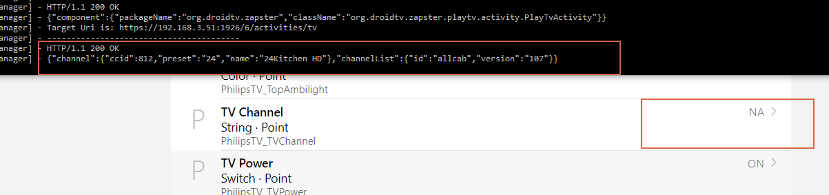

Here is the port I did for OH3. For me this got me going. Maybe it saves you bit of time. I also did some spotless:apply and fixed some null annotations which prevented maven from compiling it cleanly.
Only 1 issue I saw, (not sure if this related to OH3 version or it was there before): the TV channel name remained NA, though the response has a TV channel. Did not further dig into that yet.

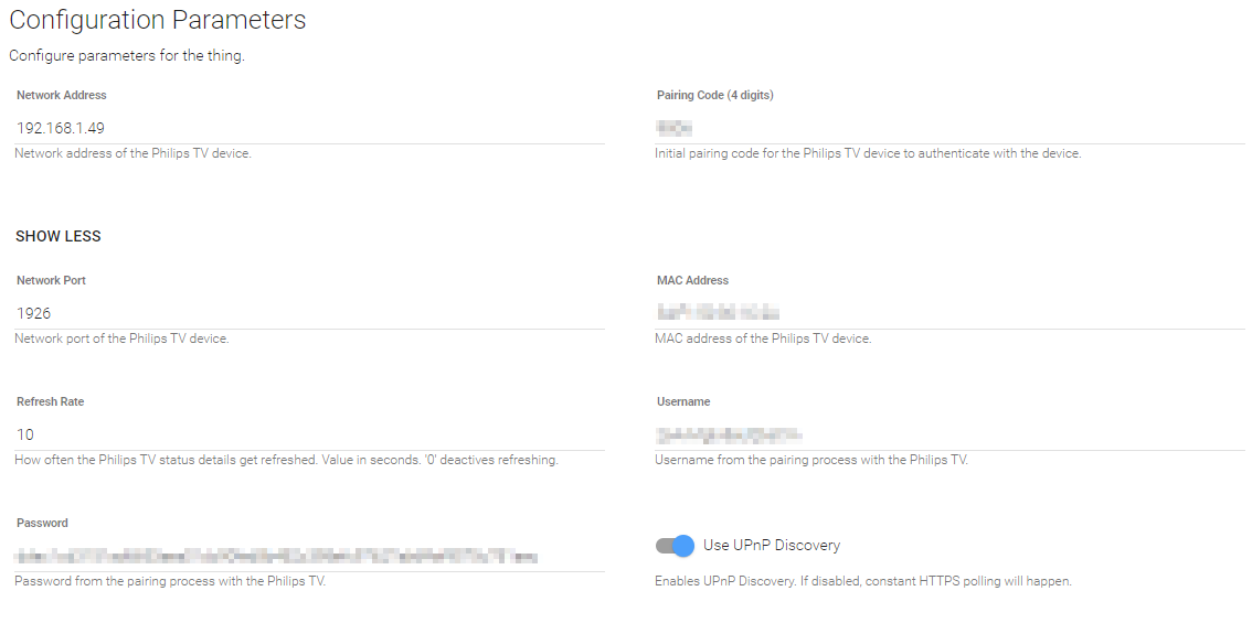

@bennYx0x
Installed on my 65OLED804/12 and the connection is working.
The list of apps are also there and I can switch the apps.
But I don’t get the current app or the app icon image.
The Refresh Rate is at 10 seconds.
I see in the logs:
2021-01-04 15:21:45.959 [INFO ] [tv.internal.handler.PhilipsTvHandler] - Starting Refresh Scheduler for Philips TV PhilipsTV with refresh rate of 10.
So it seems all is working fine, but I don’t get any updates of the current state.
My configuration:
If it could help this is the system output of my TV with JointSpace API 6.4.0:
