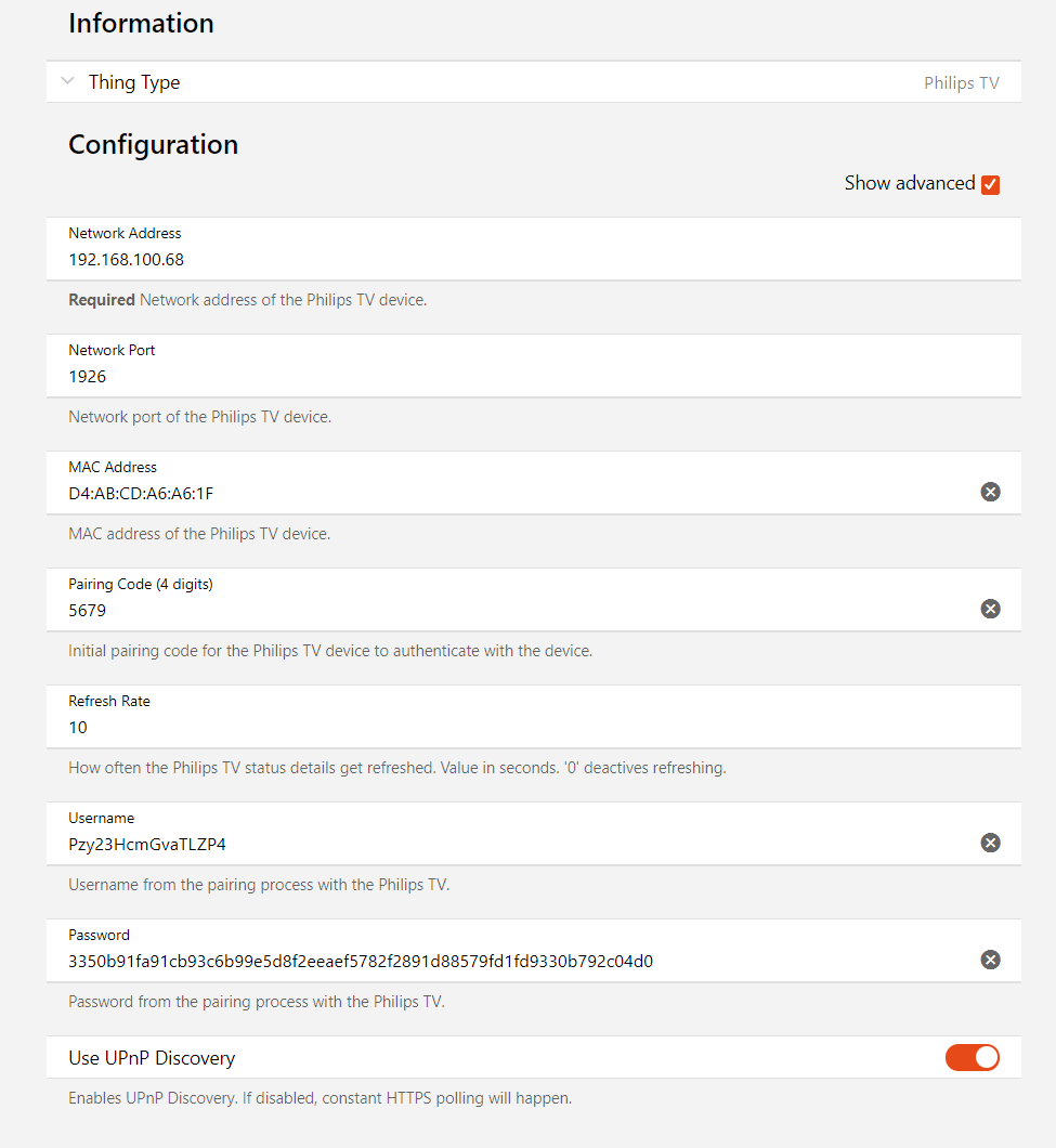

I have the same, but litte diffrent.
Apps Reading is not possible on http, only upnp.
on my 55pus7272 this will always working,
on my 55oled854 works this only after the tv is just started, after using like 3 apps, it stopped working.
if I send the command “TV” to the app channel on the 55pus7272 goes to the last hdmi,
on the 55oled854 he does the same but a black screen ? and is i referesh with the remote it works ?
maybe on the background are running to mutch apps? maybe somebody has a idea, i really need this for my surround system to choose the good audio settings.

@chrisonline could you set the logs to DEBUG and post the output? Then we’ll see what is going on during the refresh.
@Whininie if the refresh works and suddenly stops, it might be that the tv stops responding if there are too many requests / refresh attempts. You could try out this experimental version and see if it helps: https://github.com/mebe1012/openhab2-bindings/raw/philipstv/bundles/org.openhab.binding.philipstv/release/org.openhab.binding.philipstv-3.1.0-SNAPSHOT-EXPERIMENTAL.jar
Thanks for your response!
Still on the 55pus7272 it works,
On the 55oled854 no respone at all on the experimental, no app icon, no readable app name. only commands is working.
@Whininie could you then enable debug logging for further insights?
You can do so via the openhab-cli with the command

i started netflix, videoland, and Kodi but no response

Current config looks like this
Did I miss anything or did something change here?
