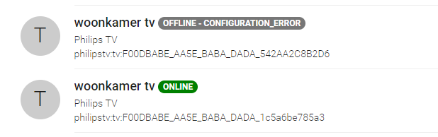

Is it expected that discovers the same tv multiple times?
It seems to give some conflict over the code
Nope, thats not intented.
The autodiscovery looks for UPnP devices from the tv. I already adjusted that to create only one tv thing for the UPnP device with description “Media”, which fixed the autodiscovery for 2018er models.
Looks like your tv model exposes more than one UPnP device with that description. Could you share your tv model name and set the logging level to DEBUG? The found UPnP devices are logged constantly and should shed some light on this matter.

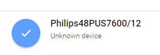

I first tried my own TV. It was found automatically.
Status afterwards in PaperUI:
Status: UNINITIALIZED - HANDLER_INITIALIZING_ERROR com.google.gson.stream.MalformedJsonException: Use JsonReader.setLenient(true) to accept malformed JSON at line 2 column 2 path $
Your TV model 48PUS7600/12 is from 2015 and therefore does sadly not support the newest Jointspace API.
