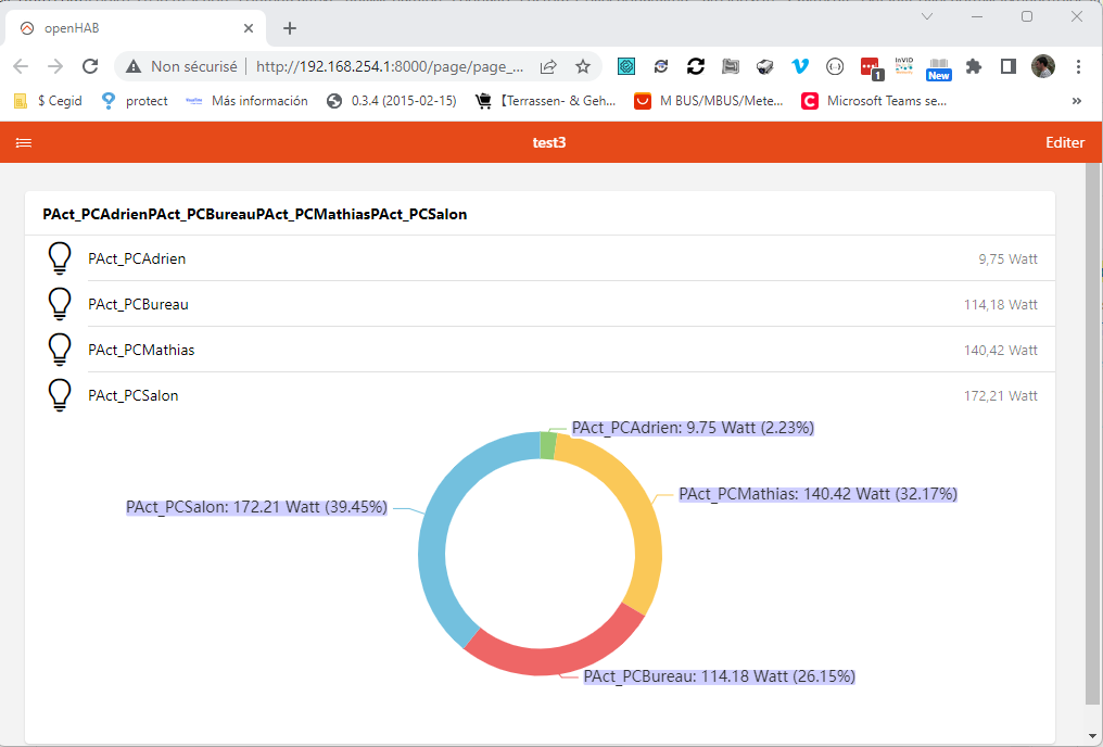

My current code with individual items is :
   - component: oh-chart
        series:
          - component: oh-data-series
              height: 250px
              radius:
                - 70%
                - 90%
              label:
                formatter: "{b}: {c} Watt ({d}%)"
                position: outer
                fontSize: 14
                backgroundColor: "#cfcfff"
                borderColor: "#ffffff"
                borderWidth: 2
                borderRadius: 2
              selectMode: single
              type: pie
              min: = 0
              max: = 100
              data:
                - value: =items.PAct_PCAdrien.state
                - value: =items.PAct_PCMathias.state
                - value: =items.PAct_PCBureau.state
                - value: =items.PAct_PCSalon.state
              axisLine:
                lineStyle:
                  width: 10
I was hopping using an oh-repeater also there, but not sure if it will work, or if my syntax is just broken.
This current code bellow just display nothing :
data:
- component: oh-repeater
for: i
in: =props.item
fragment: true
default:
- value: = loop.i.state
Do you have any advice of how to fix this ?
