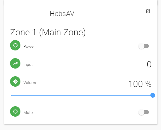

“power/input/mute” work well but “volume” doesn’t fit to the Pioneer volume dB ranges:
The Pioneer VSX-1131 has a volume range from -82 dB to 0 dB.
I created a dimmer item and put it as slider item into sitemap. But slide range 0% to 100% doesn’t match to volume range -82 dB to 0 dB. 0% is 0 dB but 100% is only -32 dB!

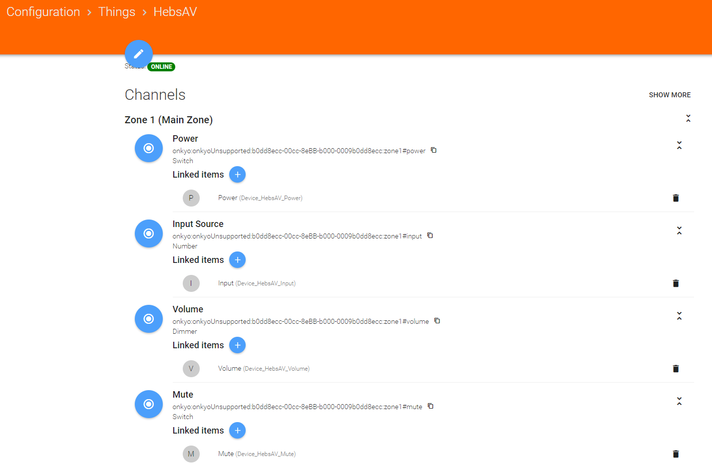

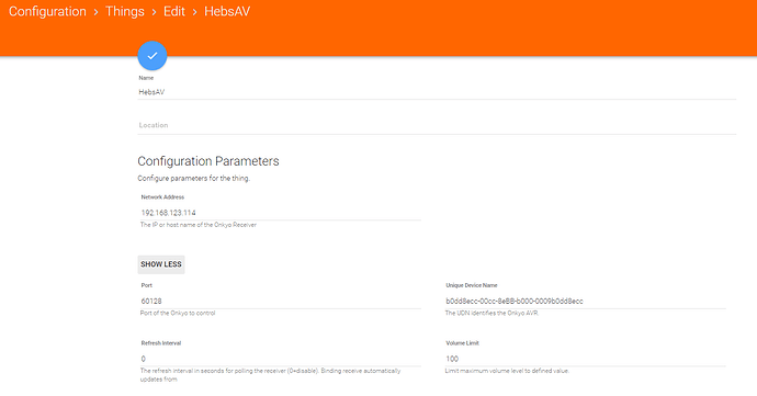

as described first I added thing for “Onkyo binding” and found my AVR automatically. Here the settings:
And here the linked items:
So first that looks fine in the PaperUI but in PaperUI Control the items don’t work (e.g. power or mute)
So I think before we go forward on the volume issue first the “standard control” of the AVR should work!?

my understanding is that the linked volume item to the thing “HebsAV” must be a Dimmer…so I linked my item Device_HebsAV_Volume. But I also created a number item VolumeAV1 and in sitemap this SetPoint:
