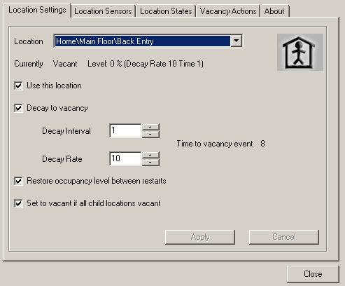

Below are a few screenshots from a Occupancy plugin I wrote for Girder about 10 years ago… it accomplished all of this by using Locations within the house, the devices/sensors in that location to set when the room was occupied, each room would have a preset decay rate, and when empty, the various devices could be set to turn off ….
