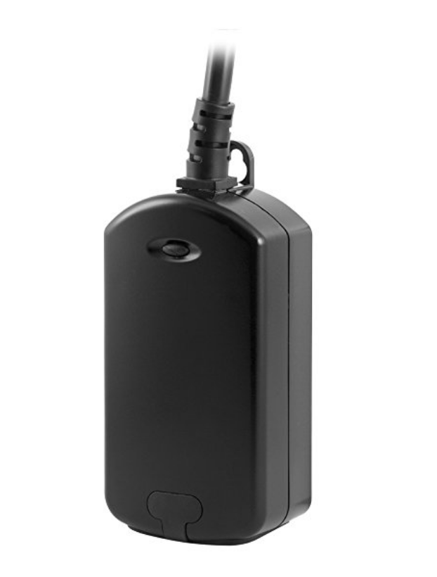

Hello…
This device (generically defined as a binary switch) is detected by my little Z-Wave RPi controller - but I can’t control it at all as it’s listed as an “Unknown Device” and no channels are available. BUT - it knows it’s a generic binary switch - so why can’t I just toggle it? Why is that channel hidden?
Regards,
Mike
Can you provide the manufacturer and model number of the device, as well as the version of openHAB you’re running?
Hi Mark,
Sure - sorta. It’s a GE/JASCO “Plug-In Outdoor EZ Smart Switch” - ZW4201
However, Lowe’s (point of purchase) shows it online as a “GE Z-Wave Black Remote Control Lamp Module”.
Looking at the box, the most notable part number appears to be ZW4201.
I’m running the latest distro - 2.2.
Hmm. From what I can see, it looks like it might be the same as the GE/Jasco 45604. Does it look like this?
If so, I have two of these in my network, and they included just fine.

Hi Mark,
Yes - that looks like the device. However, it’s a Z-Wave Plus model. The XML is different for deviceId and deviceType:
<manufacturer>0x63</manufacturer>
<deviceId>0x3032</deviceId>
<deviceType>0x4f50</deviceType>
Maybe that’s the catch? I can supply the whole file if you like.
They’re functionally identical. I’m not sure what Z-Wave Plus means but I believe it’s all about extending the pairing range - which shouldn’t matter much to openHab. It’s probably a simple database tweak. Happy to help with that - just not sure where.

Running 2.4 I ran into the exact same problem with the GE Zwave plus outdoor plug (ZW4201 / Jasco 14284-2), after removing and rediscovering it came up without a problem.. device id: 12338
I just bought two Jasco ZW4201 but it is coming up with slightly different info:
<node>
  <homeId>0xf49dc6c7</homeId>
  <nodeId>51</nodeId>
  <version>4</version>
  <deviceId>0x3033</deviceId>
So it’s not being recognized by openHAB 2.5.4-1 (Release Build), it comes up as " Z-Wave Node 051 (0063:4F50:3033:5.20)". is this a matter of updating the zwave database again?
I’ve updated the database so this should be resolved in the coming days (I’ll do a database update in the binding tonight).
