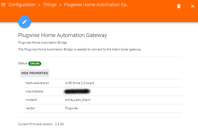

Hello fellow OpenHAB enthusiasts!
I have a Plugwise Home Automation system at my home for which I recently developed an OpenHAB binding. My goal is to further improve this binding with some additional features and to improve how the binding communicates with the Plugwise API.
At this moment my binding is fully working (I use it on my own home OpenHAB instance) and enables me to monitor and control all my thermostats, radiator valves and my floor heating pump.
I have already submitted the binding to the Eclipse Marketplace and I hope to create a PR for the OpenHAB repository as well as soon as I have made sure I’ve ticked all the necessary boxes for a proper PR.
You can find my forked repo along with the org.openhab.binding.plugwiseha-2.5.2-SNAPSHOT.jar file on github. This is the link to the README.md file.
I’m not sure how many of you use this system at home - I know of at least one other person who is a personal friend of mine - but I’m hoping that by posting this some of you will test drive the binding and give me some valuable feedback.
Have fun!

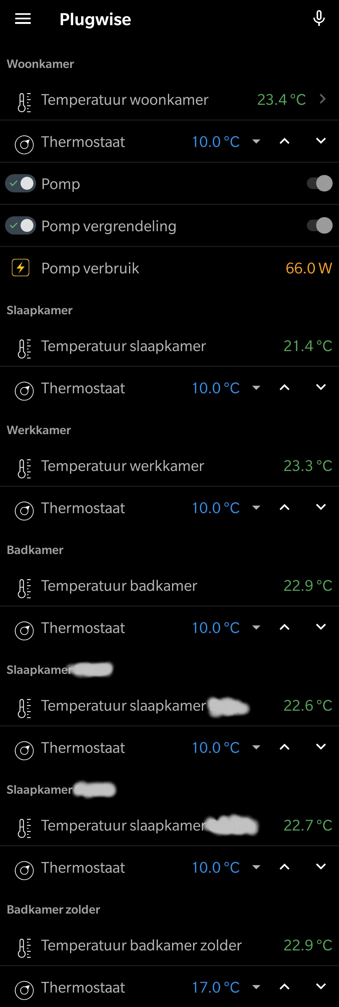

Edit: A picture is worth a thousand blog posts…
Sitemap:

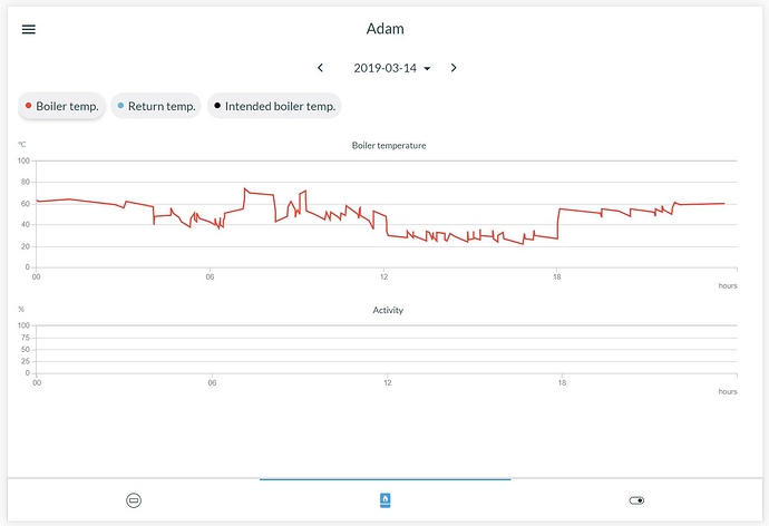

This is correct in my understanding. To illustrate this behavior, this is the boiler temperature graph from last March:

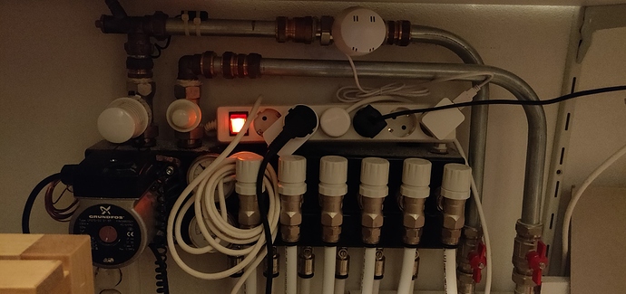

I had a plumber install a thermostatic valve next to my floor heating ‘distributor’… So I still have the ‘conventional’ knobs on the distributor that control each loop - but since I also really have one zone like you, I thought it would be easier to just install a new thermostatic valve on the assembly next to it. I’ll see if I can post a picture for you…
The top most white knob you see is the Plugwise Tom. You can also see the circle controlling the pump.

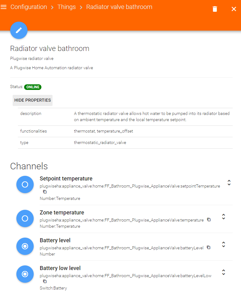

The channel: batteryLevelLow is that something Plugwise provides(cant find it in the web interface) or functionality you added within the binding?
This is indeed something that I added in the binding; it can be configured on the appliance Thing (default setting is 15% battery level)

I have a question, it’s not really about the plugwise stuff but I really like your sitemap.
The up/down arrows at the thermostaat and the green checks in front of the Pomp and Pomp vergrendeling.
Can you maybe share that code (can be a private message or just here in the thread)
I’m still very new too openhab and still learning how to make everything.
@robbie_demaegdt Thanks for the compliment! I have no problem sharing (part of) my sitemap with you - but I have to admit that aside from the icons which I customized the rest is ‘just’ the OpenHAB app for Android. I believe some widgets are rendered differently on the IOS app (for example the setpoint dropdown selection if I’m not mistaken)
I use the AMOLED black theme on the Android version of OpenHAB. The icons were created by me (.svg vector format) using the free Inkscape tool and by looking online for icons that I could use. (ShareIcon.net) The part of the sitemap which interests you is this :
