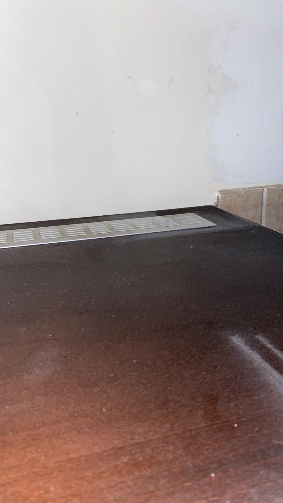

but i will need some kind of cooling anyway , as i am puting them in a wood cabin
at least one of them has some kind of vent out…
