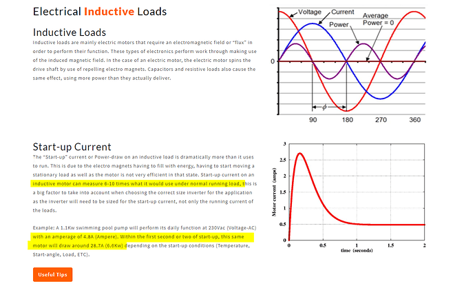

i remmber that not all ESP smart switches are not comfortable with inductive load…

it will work i am not saying it will not … but after some time the relay will die…

not really about watts, but amps … sonoffs are using 16A relays, which is more than enought for basically anything of home/garden appliances.
My industrial rated water pumps have 6A to start, that’s why I’m using 10A relays, no need to have more on those.
