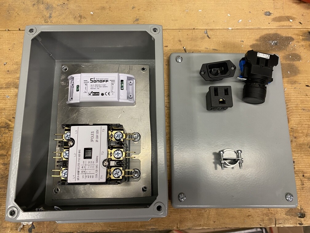

I’m building one with a Sonoff and a 40A contactor. Then I can run Tasmota. Extending the button and LEDs to outside the enclosure.
It is hard to get the materials for this for under $100 USD.
I’m building two - one for a 220 (split phase) water heater and one for a well pump.
Nice, but as this is a metal case (at least it seems to be) I doubt that you will be happy with WLAN :wink:
Maybe it’s possible to build an external antenna.
You will need other sockets for 40 A :smiley:
