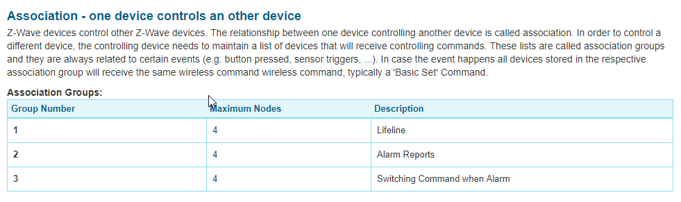

How did you do that. If I want to associate the other sensors I can only add 4 other sonsors because this would be my preferred solution as well. Besides that, which association group did u use? I guess you deactivated the automatic association as well?
Christian
I have 5 Popps, I had exactly the same problem. I changed Parameter 3 to 99 (from -1 =255) and Parameter 5 and Parameter 6 to “inactive”. Then I put them into “Assoziation Groups” 2 and 3. But it’s recommended only to put 4 further more sensors into one group!

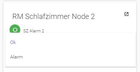

I am just wondering what the right “item received command” attribute is, when checking in a rule?
Is it “Alarm” and “Ok” as indicated in the Paper-UI Control? Or is it ON / OFF ?
if item ZAlarm2 received command Alarm {
