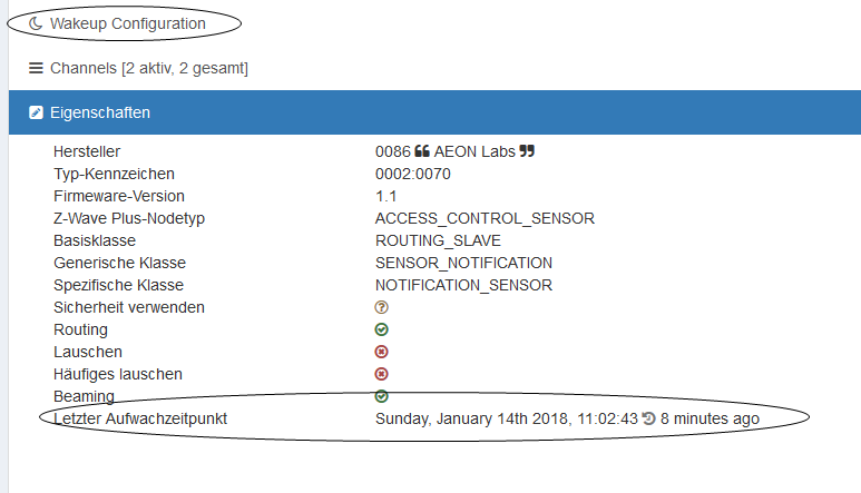

I discovered an other problem:
Can someone verify this?
Wakeup config: yes
Last wakeup time: no

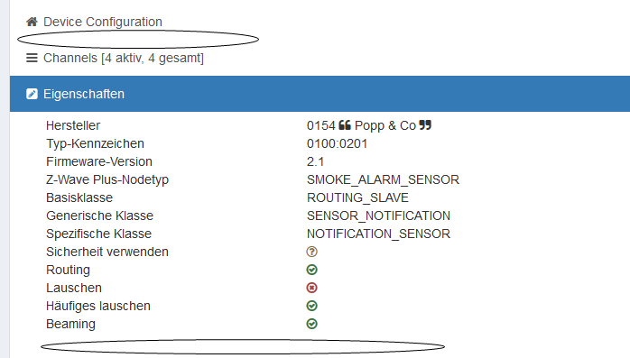

@sihui
Which Version of the z-wave binding do you use?
Latest dev/security
Don’t forget to manually wake up the device several times , :sunglasses:
Yes I know,
but in Papuer-UI the settings for “Wakeup config” are not shown. See my screenshot.
This is why I ask.

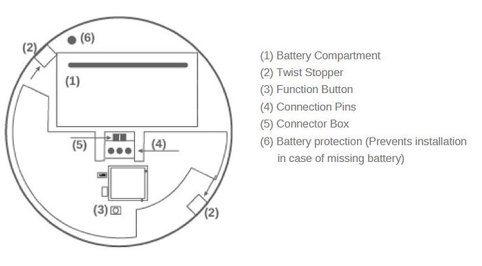

Not the config, push the button! :rofl:
Once included a simple click on button (3) will
issue a Node Information Frame.

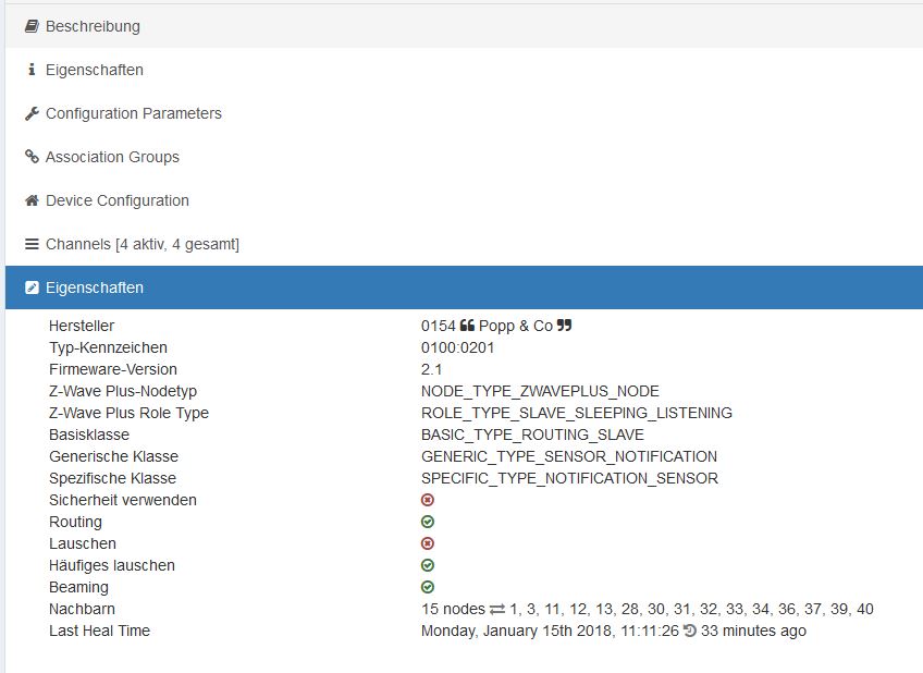

Ok, you want to tell me, that the device is not fully recognized due to missing NIF? If fully recognized, then this settings “Wakeup settings” will be created by the binding to us in Habmin?
Yes for the “Last heal time”, no for the wakeup config: the device has no wakeup config.
Ah, ok, understood. I interpreted this wrong.
