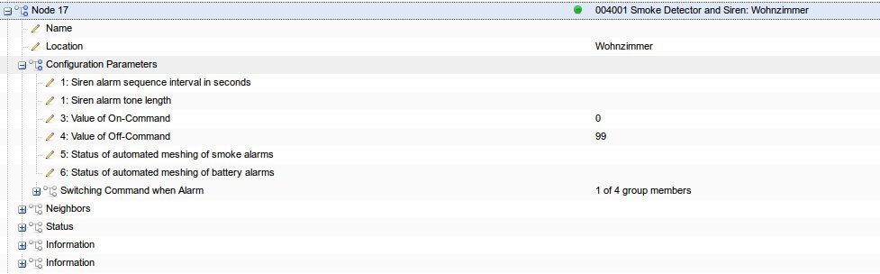

I bought a Popp Smoke Detector and included it into my zwave-network.
I configured the device using openhab-habmin:
My problem is, that I don’t get the alarm information on the openhab.sitemap :frowning:
The definition in my items-file is as follows:
> Contact iLivingRoom_SmokeSensor “Brandmelder Wohnzimmer [%s]” (gWohnenEG) { zwave=“17:command=sensor_alarm,alarm_type=1” }
> Contact iLivingRoom_SmokeSensor_Tamper “Brandmelder Wohnzimmer tampered [%s]” (gWohnenEG) { zwave=“17:command=sensor_alarm,alarm_type=0” }
> Number iLivingRoom_SmokeSensor_Battery “Brandmelder Wohnzimmer Batterie [%d %%]” (gWohnenEG) { zwave=“17:command=BATTERY” }

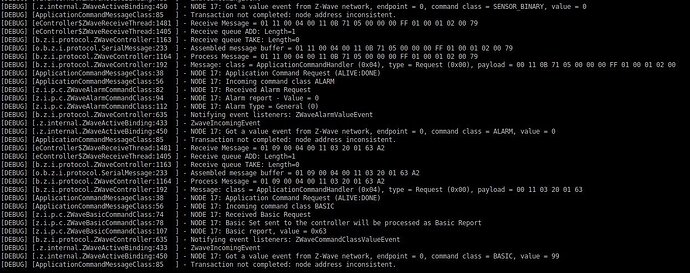

In openhab.log I can see the notification about tampered alarm over the zwave network as follows:
I can’t explain why it isn’t working for me.
I think I have to change parameter 3 and 4, but I don’t know the right values (default is 99 for both).

Checked in log-file but there is not signal when I take the sensor out of the “base”

I would also have expected maybe a 99% on at least one device, even if they are new. But all 6 report 100%
@chris
Ok, the device is reporting a value = 100
And now?
Should we ask Popp support? Or should we change a parameter?
