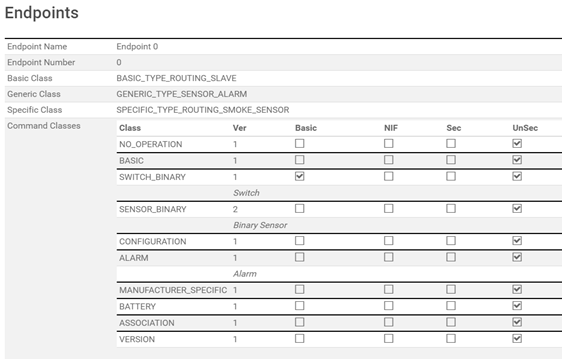

Nope, this is now the Basic checkmark in the zwave device database.
Yes, but it depends on the config settings of devices: for some devices you can switch between multilevel command class and basic command class.
Does it hurt if I add it (respond_to_basic=true) anyway? Only for testing?
I’m pretty sure you will get a syntax error in your log.
.. and it is already set in the database:
grafik
I don’t know if it will hurt, but at best it will not do anything as this is only usable for the OH1.x binding.
This link is not the zwave docs, so who knows where it has come from :wink:
