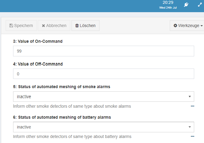

I changed parameter 5 and 6 with Habmin, because I don’t want to mesh the smoke alarm and low battery alarm through the whole house.
I don’t understand - sorry. If you changed parameter 5 and 6, even with HABmin, then you are still changing the parameters. :confounded:
In any case, I don’t know what these parameters do, and from what I can see in the logs, it’s not changing the channel state anyway - this is always processed in the same way.
Sorry - I feel I’m misunderstanding something here, for which I apologise.
Before I ever started with any item configuration (2 years ago) I included 5 Popp Smoke Sensors (004001) via inclusion mode. (node3, node4, node5, node6, node7)
Then I went to Habmin and changed things → Configuration Parameter: 5 and 6 to inactive:
THEN I NEVER CHANGED IT AGAIN.

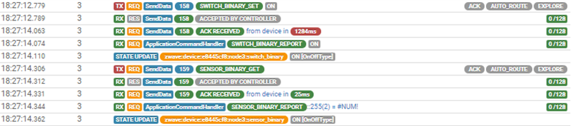

node3: channel: sensor_binary is configured as Switch (in .items file = POPP_Smoke_1_A)
18:27:12.754 [INFO ] [smarthome.event.ItemCommandEvent     ] - Item 'POPP_Smoke_1_Sw1' received command ON
18:27:12.759 [INFO ] [smarthome.event.ItemStateChangedEvent] - POPP_Smoke_1_Sw1 changed from OFF to ON
18:27:14.366 [INFO ] [smarthome.event.ItemStateChangedEvent] - POPP_Smoke_1_A changed from NULL to ON

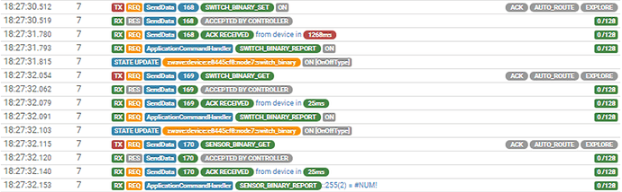

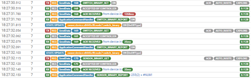

node7: channel: sensor_binary is configured as Contact (in .items file =POPP_Smoke_5_A)
18:27:30.494 [INFO ] [smarthome.event.ItemCommandEvent     ] - Item 'POPP_Smoke_5_Sw' received command ON
18:27:30.498 [INFO ] [smarthome.event.ItemStateChangedEvent] - POPP_Smoke_5_Sw changed from OFF to ON
nothing else happens…
A comparison of node3 and node7:
Both SWITCH_BINARY doing exactly the same. They switch on the SIREN! → this is OK!
And both devices (node3 and node7) then get a SENSOR_BINARY_REPORT::255(2) = #NUM!
node3 (SENSOR_BINARY = configured as Switch) can interpret 255(2) = #NUM! → ==ON
and then POPP_Smoke_1_A changed from NULL to ON
node7 (SENSOR_BINARY = configured as Contact) can NOT interpret 255(2) = #NUM! → NOTHING ELSE HAPPENS!
So, now the question is: "Why does the device switch ON automatically also SENSOR_BINARY = smoke alarm?

But I could change parameter 1 and 2 (to find out!)
Parameter 1: Siren alarm sequence interval
The additional siren is creating a different acoustic signal differentiate from the smoke alarm. This sound is partly on and partly off. This parameter defines the total length of the interval in seconds.
Size: 2 Byte, Default Value: 10
Setting Description
03 - 127 seconds
Parameter 2: Siren alarm tone length
The additional siren is creating a different acoustic signal differentiate from the smoke alarm. This sound is partly on and partly off. This parameter defines the total length of the sound versus silence within this interval.
Size: 1 Byte, Default Value: 08
Setting Description
03 - 127 seconds
