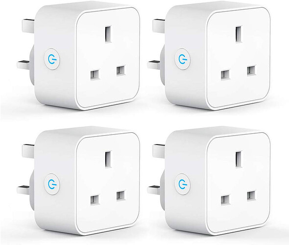

The first plugs I bought were TPLink HS110 which cost a shedload and are big and bulky. Not practical for “In-sight” use.
I recently bought some of these
For a pack of 4 it cost £38 which is dirt cheap.
They handle 13A and are fused (non-replaceable without a soldering iron)
I also bought some of these
https://www.amazon.co.uk/gp/product/B07PH28N1D
Again, less than £10 a plug. These have a relay in them marked to 16A so some “safety” headroom there. (We have to remember, less than £10 and from China… :frowning:)
They’re both flashable with the Tuya Convert and then Either Tasmota or Espurna (But I did brick one as I uploaded the wrong firmware. Getting to the uart is a PIA)
Anyway, these two do work nicely with Tasmota, mqtt and OH :smiley:
(not adverts or affiliate links - just an FYI)
