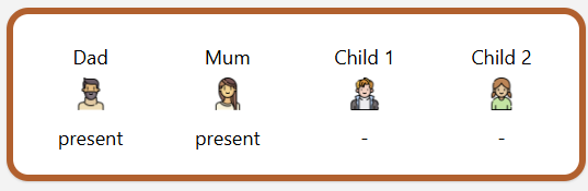

Presence - Card from ScrewPlate
Here is a widget with which the presence and absence (also the duration of the absence) can be displayed.
ScrewPlate will be a template set with various widgets, all of which are highly customizable in a unified style. More information on GitHub
Since version 1.2, you no longer need to use an extra rule. You just need to create an item (DateTime) with a profile (timestamp of the last change) and select it to display the time of absence.

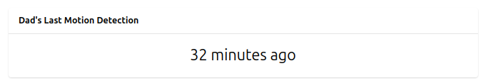

You could use an expression in the widget for this instead of the rule.
component: oh-label-card
  item: MotionSensor_LastMotion
  label: =dayjs(items.MotionSensor_LastMotion.state).fromNow()
  title: Dad's Last Motion Detection

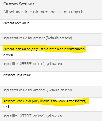

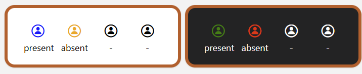

Is there a way to change the colour of the presence-icons due to state? Would’ve loved it, if the icon was red for away and green for present?
Anywhere you see a color element there is already an expression. For example:
                                  color: "=props.contentIconColor ? props.contentIconColor : (themeOptions.dark
                                    === 'dark' ? 'white' : 'black')"
You can replace that expression with one that tests the presence of the person.
                                  color: "=items[props.person1item].state == 'ON') ? 'green': 'red'"
I have added the option.

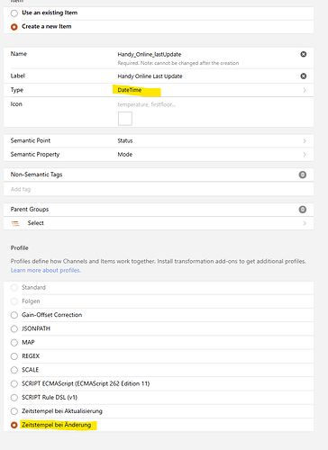

I have a DateTime item with the current value “2025-10-23 15:27:13”.
:person_shrugging: All I can say is what I posted continues to work for me.
This is a DateTime Item? Not a String? That doesn’t look like the normal formatting for a DateTime Item’s state which should look like “2025-10-23T15:27:13.123-0200”.
dayjs expects an ISO8601 DateTime String.

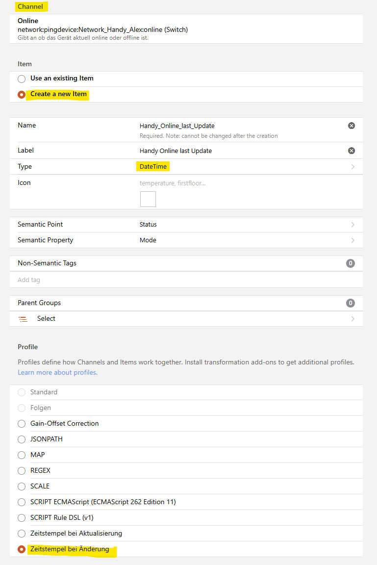

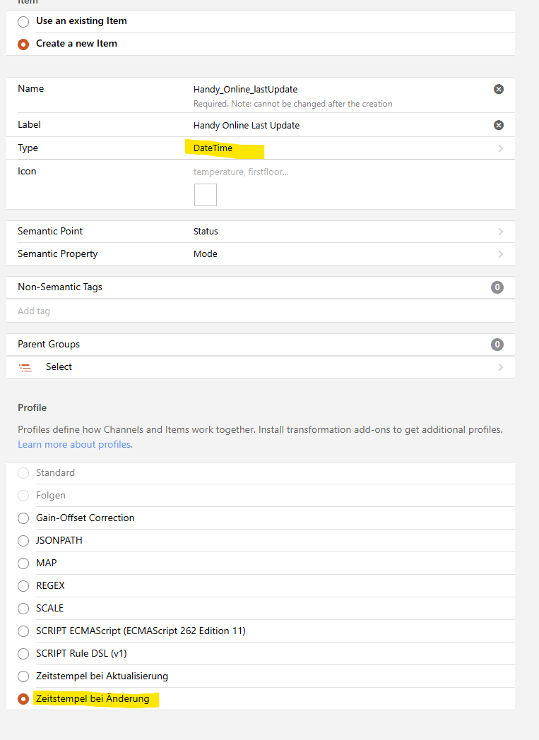

When I create an item with the last change, I get the value mentioned above.
What does that profile do?
What is the actual state of the Item? Meaning what do you see in events.log? What do you see in Settings → Items? What do you see if you log out the state of the Item in a rule?
The thing comes from the network binding and the item represents the ON/OFF status of the cell phone. In addition, there is an item in the timestamp of the last change with the above-mentioned profile.
So, in the widget with
=dayjs(items.Handy_Online_LastUpdate.state).fromNow()
the difference since the last change should be displayed, at least that’s what I thought.
I can also see the correct format in the log.
Item ‘Handy_Online_lastUpdate’ shall update to 2025-10-23T18:32:46.402221322+0200
Sorry, it was my mistake, I must have had tomatoes on my eyes.

                                        color: "=(@@loop.listitem == 'ON' ? (props.presentIconColor ?
                                          props.presentIconColor : 'green') :
                                          (props.absenceIconColor ?
                                          props.absenceIconColor : 'red')) :
                                          (themeOptions.dark === 'dark' ?
                                          'white' : 'black')"
