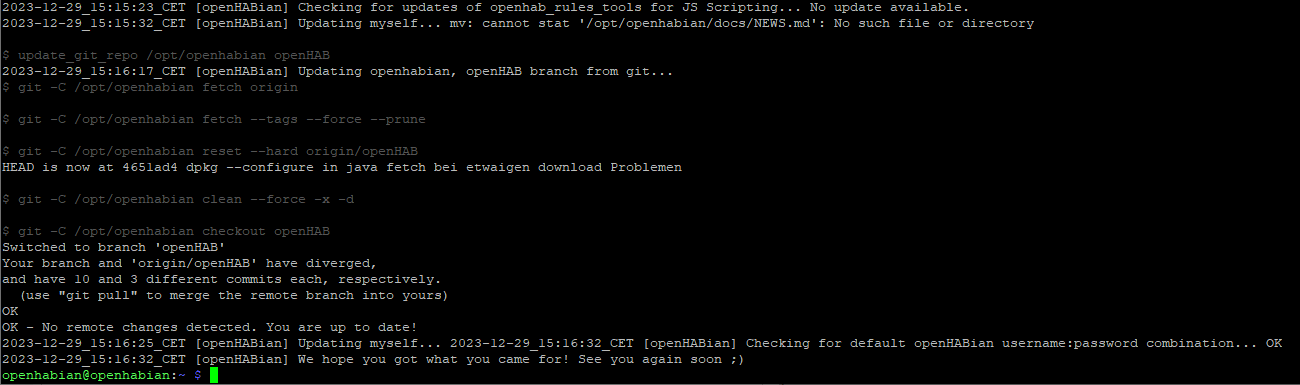

Before:
Then I switched to release:
The Console:
Your branch and ‘origin/openHAB’ have diverged,
and have 10 and 3 different commits each, respectively.
What the meaning of that?
