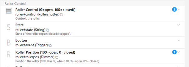

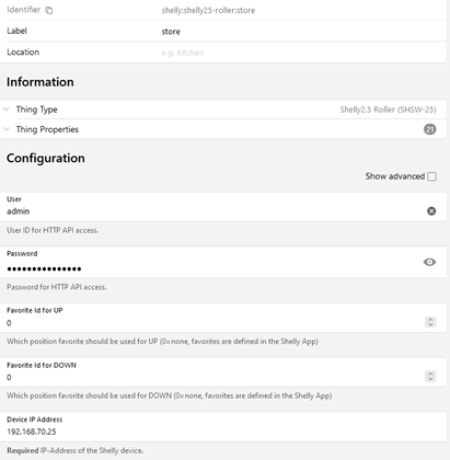

I use for my home automation the openHAB 3 software and recently I acquired a Shelly 2.5 module to control the blinds of my veranda.

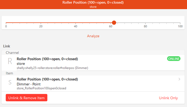

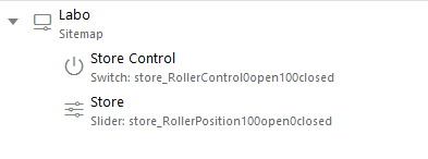

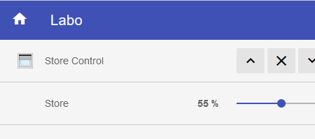

I manage from the interface “Basic UI” to command the blinds, UP, DOWN and also the position from 0 to 100%. These commands work very well.
I use the “binding : iCalendar” to control the position of the blinds.

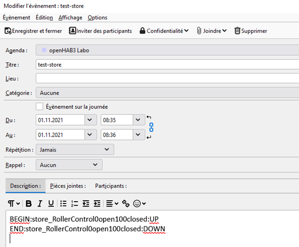

From iCalendar the UP/DOWN commands work fine, but it is impossible to transmit a position to the blind from 0 to 100%.

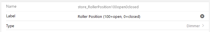

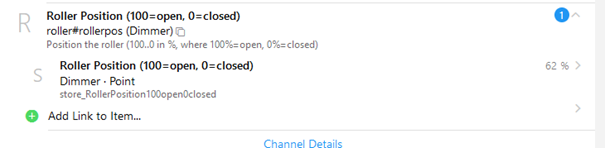

I use the following “item” for position control: store_RollerPosition100open0closed

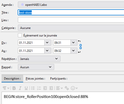

I put this command in the calendar to try to set the blind position to 50%.
BEGIN:store_RollerPosition100open0closed:50
