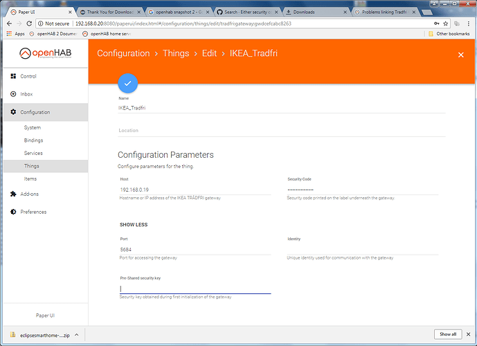

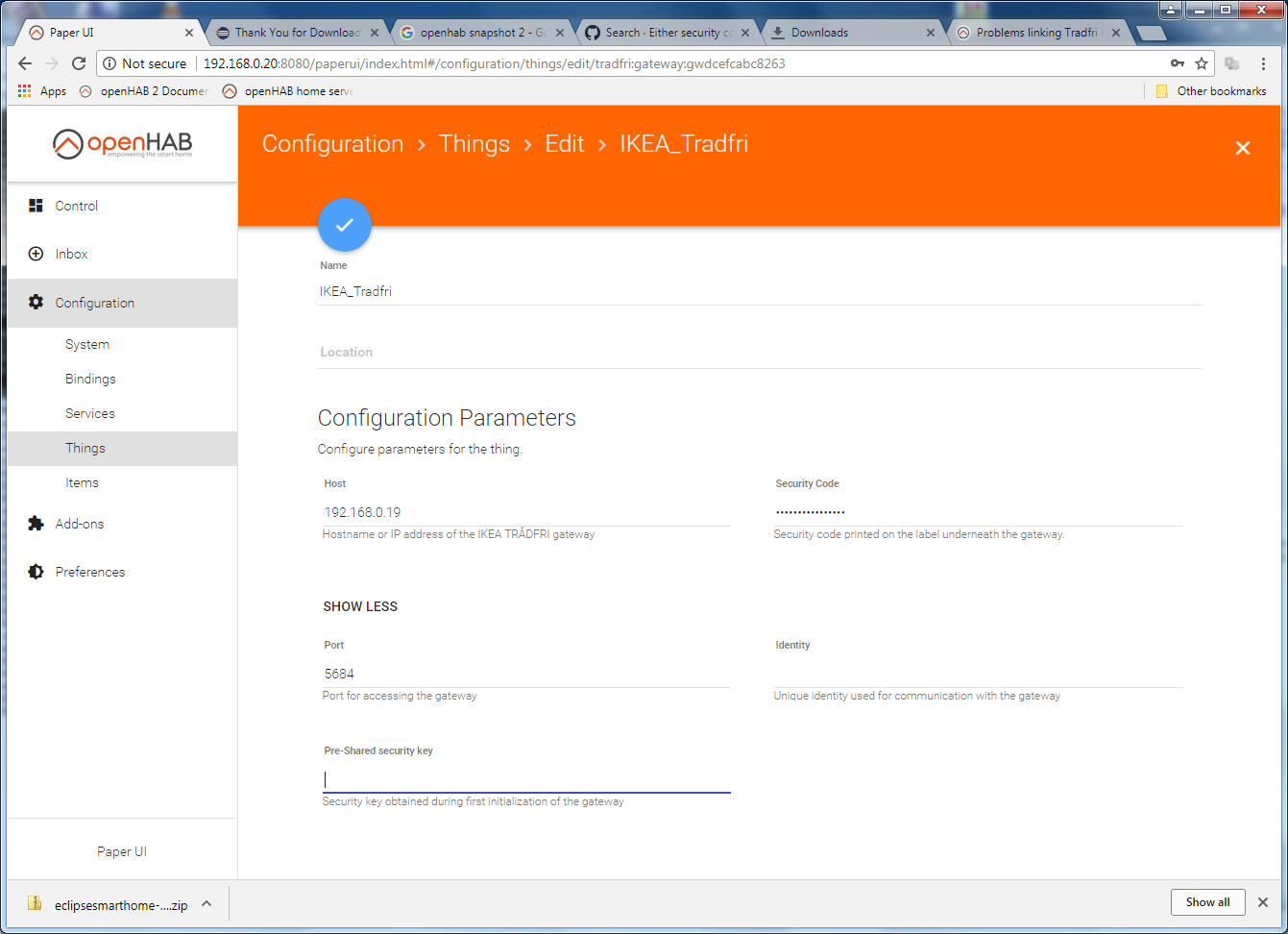

I Have a very similar problem with my IKEA Tradfri Gateway.
Started out with a Openhab 2.2.1 and that did not detect the gateway at all.
Upgraded to 2.2.2-snap: Now the gateway (Current firmware 1.2.42) is detected with an IP adress but never gets online. I am unsure if The Pre sheared security key is returned from the gateway. I have seen “****” in the line but I am unsure if that was my browser propsing to use the security code as I asked Chrome to remember the “password”
I have tried restarting, rebooting, removing the bindings and installing again without success, and even scanned the DOT matrix code (renegade2k) to ensure that the security code was correctly printed.

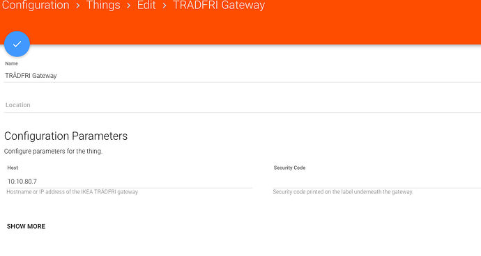

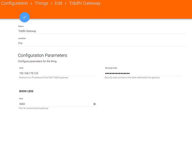

I’m really not a pro, but several things seems strange to me.
  1. I see your Headline - “Configuration > Things > Edit > Ikea_Tradfri”. When i edit mine, it looks like "Configuration > Things > Edit > Trådfri Gateway ". Are you sure you chosen the Tradfri Gateway, as you was detecting your “thing”?
  2. You got “identity” which might be the MAC-adress and “Pre-Shared key” which is a riddle to me … Mine for compare:
    Maybe the last point is which makes you GW looks like offline, cause your log says
Either security code or identity and pre-shared key must be provided in the configuration
So it seems even you entered the security key your config still waiting for identitiy and PSK
Thanks for your feedback. The difference in the GUI is because I’m using 2.2.0 snapshot an have named the gateway.
Still not working so I’m getting a little irritated. :slight_smile: I guess I’ll just have to wait for an update.
