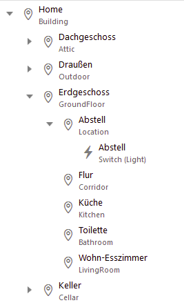

    I use some Configuration Files for my KNX-Things/Items. When openhab ist running and I modify Location, Point or Property it is correctly sorted into the model-tree. After restarting openhab via “systemctl restart openhab” the item is not longer sorted correctly, its showed “under” the tree.
    No Problem with my Deconz-Items, but these are configured via GUI. I’m not sure if it’s a bug or if I made something wrong :wink: - any ideas?
KNX-Items Configuration (only edit my KNX-Items via Textconfig!):
Switch Abstell_Licht “Abstell [%s]” (GF_Abstell) [“Switch”,“Light”] { channel=“knx:device:bridge:Schalten_EG:Abstell” }
After changing the item-configuration, but before restart:
After restart the Location “Abstell” is empty and the item shows up as a sibling of home. Cannot append a screenshot because I’m new here and not allowed to append a second one…

Look at the first image in the post. Abstell (Switch) is in the semantic model when live editing item files. After restart, this guy is moved to the root of the semantic model (so loses the assignment to the Abstell (Location). The poster was calling this “shows up as a sibling of home”. For me it’s outside of the model, just appearing the the bottom of this view. Again, it’s not about its actual ordering, but that it’s outside of the semantic model.

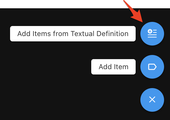

So either define the model, too from within .items files (which is really for experts only who understood the whole stuff well) OR don’t use .items files. Instead, create them outside /etc/openhab/items and import them with the option shown in the picture some posts up or create them through the UI.
