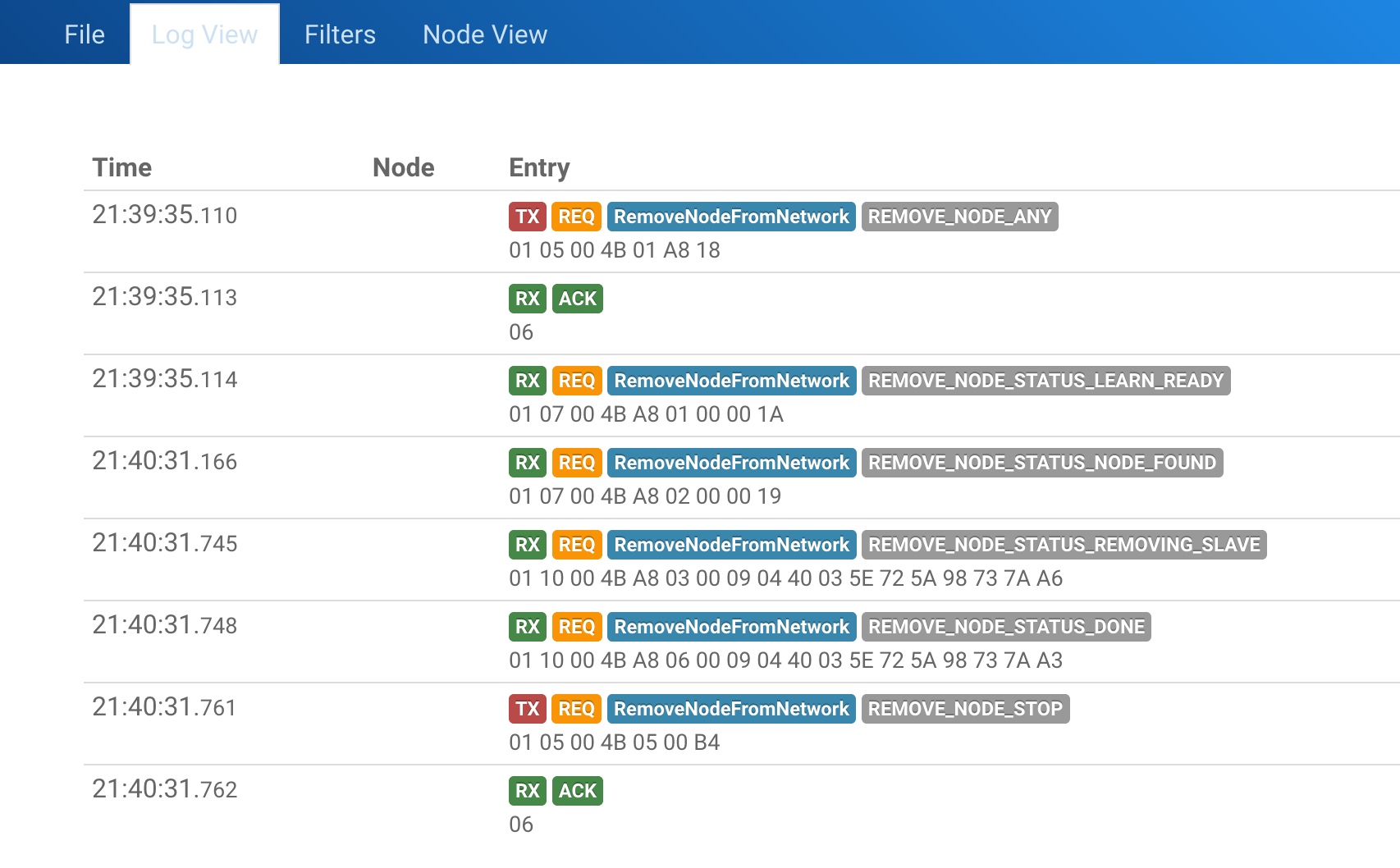

Hello, again. I’m still struggling with this. Here’s the log viewer output when I try to exclude the lock after a failed attempt to add it securely. The node being removed was node 13. Not sure if this is showing proper behavior or not. Can anyone comment? Thanks.
It looks like it removed something. There is usually a visual resonse from the device after an exclusion too. At least, there are with my locks (BE469). Are you still having trouble securely including it after the exclude?
Well, I think the exclusion is working. I’ve been able to add the lock with security enabled, although it took several tries.

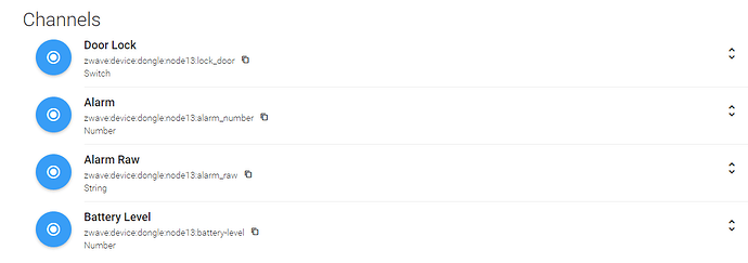

Here is a screen shot of what Channels I have, and have always had for my 914TRL Touchpad Electronic Deadbolt (as reported by PaperUI).
Door Lock lets me open/close the lock (or at least it used to, doesn’t seem to work at the moment) and changes when the door is locked/unlocked.
The Alarm channel triggers when the lock is locked/unlocked and the value indicates how according to this table:

Alarm Raw has a bit more information in it in JSON format but basically mirrors the Alarm Channel.
Battery Level is the amount of battery left and refreshingly it sees to be pretty accurate as opposed to some devices that happily report 100% until 30 seconds before it goes to 0%.
I’ve had this installed and configured since security was added to the binding (2.3 release?) and am currently running 2.5 M1.
So either there are two different 914s or something is weird going on.

There is a 914TRL (yours) and 914C (OP’s) in the database, and they are configured differently.
Ah, yeah that would apparently do it. I wonder if the 914TRL actually supports different things than the 914C? Seems nuts to use different radio/mcu hardware and firmware for the same lock (aside from the keypad), but crazier things have happened.
