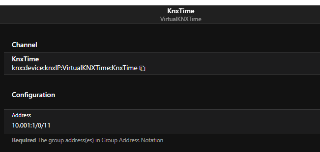

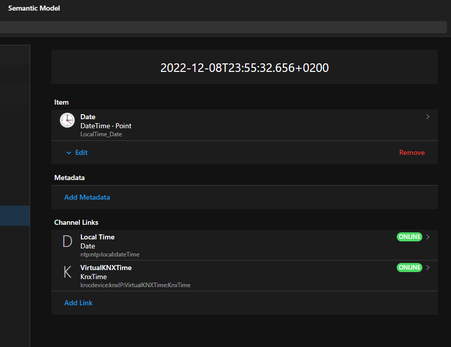

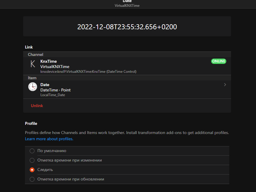

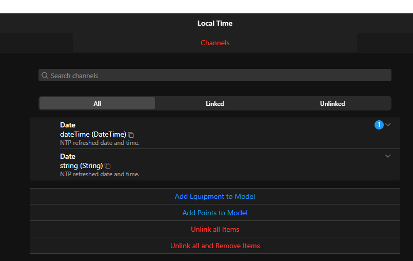

You do not need the rules. Just try to connect your humidity items from UI.
There are some picture for my project for example. I get time from NTP and send it to KNX:
