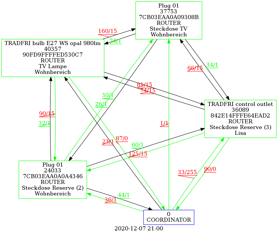

  • The zigbee_neighbors are used in a zigbee network map script that i use to see the link quality and routes in the network. Now the script shows no links, routes, quality, etc.
