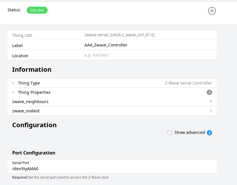

Another weird situation - the controller has no neigbours.
I already removed the controller thing and re-added it, but nothing has changed.

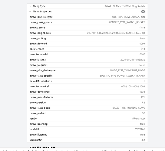

Other devices have neigbours:
Generally, the off-on behavior is indicative of network congestion. Nodes get marked offline if they do not respond to a command after three tries (with a 5 second limit) but then get marked online if they finally do answer. An event log doesn’t have diagnostic value as to the underlying cause. A ZW binding debug might show more. If your upgrade was recent, I would disable the network heal and see if things get better over a couple of days. A quicker option might be to restart OH (also with the network heal off). That would clear the current queue. Also, do you have any nodes that are permanently offline or missing as those can cause network problems (zombie nodes)?
The network map is a separate issue and is not related. There were changes in the UI for 5.1 and I thought I saw an issue related to the map (that was recently fixed). Are you on 5.1.1 or 5.1.0? The map is also not a diagnostic tool but is a pretty picture. Z-Wave network map is broken in OH 5.1 · Issue #3672 · openhab/openhab-webui

You should have the map back on 5.1.1, but the other actions won’t work right now, fixes are identified but need to be merged.
One other thing to note on the map; To accommodate 700 and 800 chip z-sticks the controller was removed from the find neighbors around OH4.1, so the arrows from nodes will only point into the controller. No worries, just assume if a node sees the controller as a neighbor the reverse will also be true.

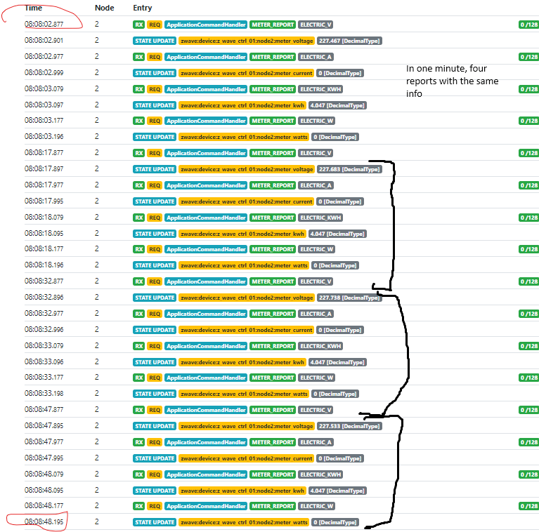

The logs:
DropBox
You need to cut your reporting way way back. Do you have the controller in more association groups than the lifeline? Also don’t use % thresholds, maybe a defined threshold like 10 watts (or some level that you really care about) report on time only if at all possible. It also seems like a lot of polls. It is hard to decipher the logs, but in general all the reporting is occupying the controller, so when you actually want to send a command, it is busy.
Not to pick on this, but the first file I opened had this in the first minute.
RED times are going to be noticeable on commands(TX-also red). The logs are filled with aborts and cancelled for commands. It is not related to 5.1, just beyond the limit of the ZW radio (100kb max)
