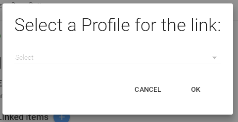

I’ve installed 2.5.0.201901020757 AmazonDashButton Binding.
Nothing happens when I press a Dash Button.
here is my .item
Switch Hue_Light3_Toggle		"Licht Bibliothek An/Aus"	<light>	(GF_Biblio, Lights)	[ "Lighting" ]	{channel="hue:0100:0017xxxxxxxxxx:8:brightness", channel="amazondashbutton:dashbutton:50-f5-da-xx-xx-xx:press" [profile="rawbutton-toggle-switch"] }
In PaperUI there is also no profile to select in pull-down-menu:
Could be that it was merged after 7:57 h on 02. January 2019?
Yes, I am pretty sure it was later. After lunch.
Ok. Thanks. I’ll wait for next build. #1487
