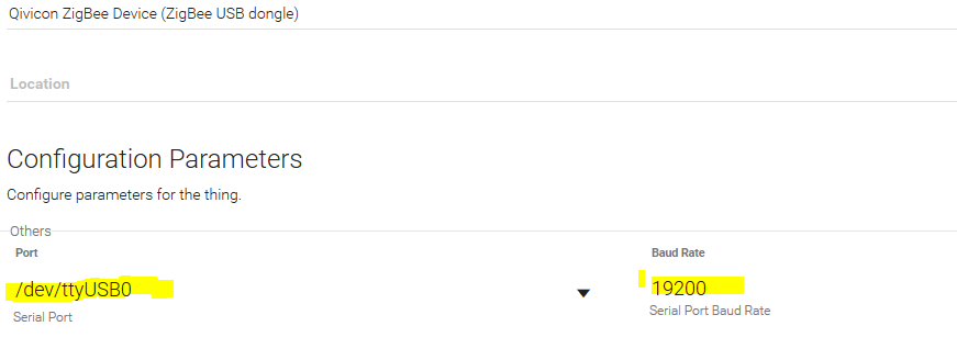

  1. Install the Zigbee Bindung on Openhab 2
  2. Configure the following (Paper UI → Configuration → Things → Qivicon ZigBee Device (ZigBee USB dongle):
