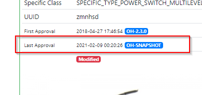

How is this different than the ZMNHSD entry in the database? It looks identical to me

You are absolutely right its there. Very strange… when i was looking earlier it wasnt there.
Well the motivation for finding it in the OpenSmartHouse database was because it wasnt recognized correctly so i had to go find it and couldnt see it. But you are right after refreshing the site and going through it again it is in fact there. im sorry.

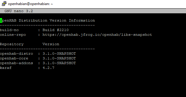

I’m running the very latest version “main” branch of openHAB
stable, milestone, or snapshot? There are latest versions in all 3. 3.0.1 is the latest stable, for instance, but does not have the latest database updates.
I would like to show you the exact version, but as far as i know its the snapshot version. But is there a terminal command i can run and give you exact details ?
I found this that may be useful if it applies to OH3 too.
To see the detailed version information, please have a look at userdata/etc/version.properties
Latest Snapshot.

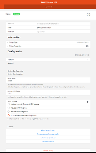

Although it doesnt recognize my device.
Try deleting the Thing & re-adding to get 6the latest binding settings.

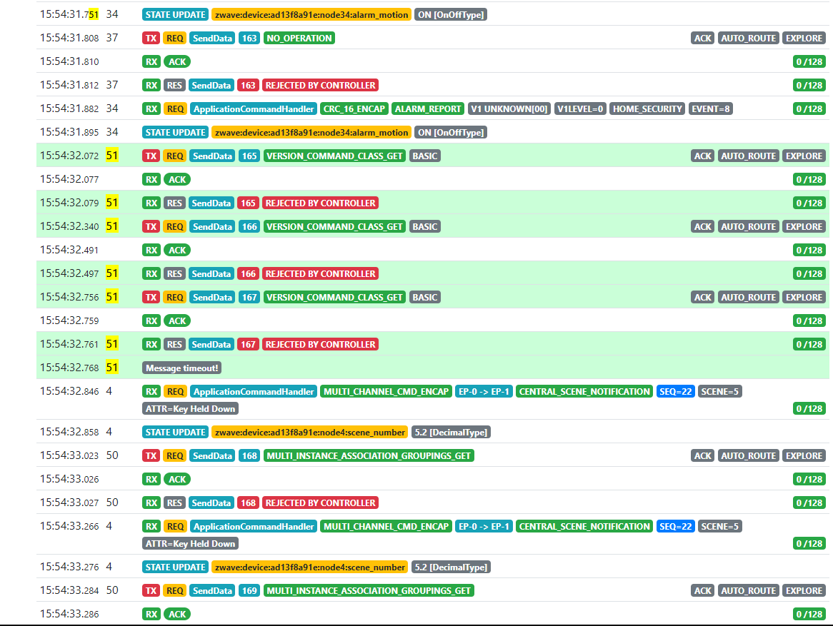

It is in the database. You should probably follow the binding docs and turn on DEBUG logging. Only unfiltered logs are useful.
Perhaps the log viewer can help too.
DEBUG is already enabled.

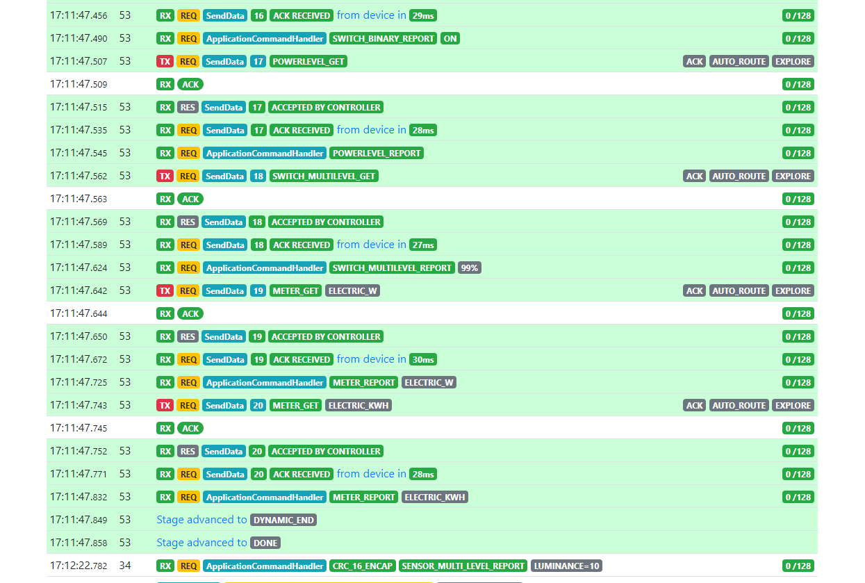

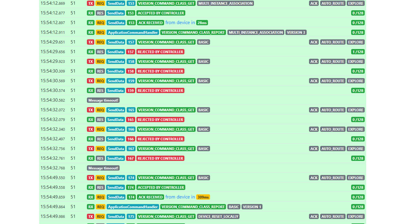

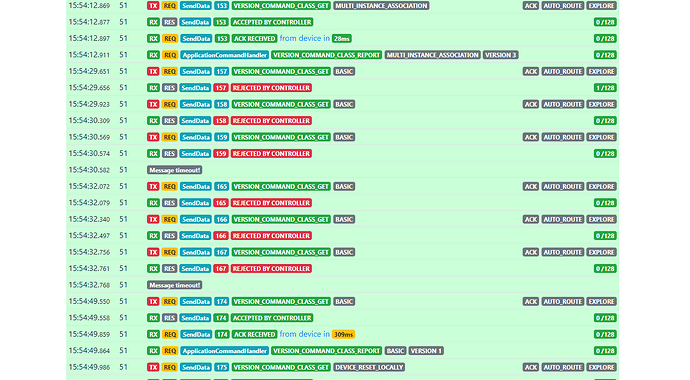

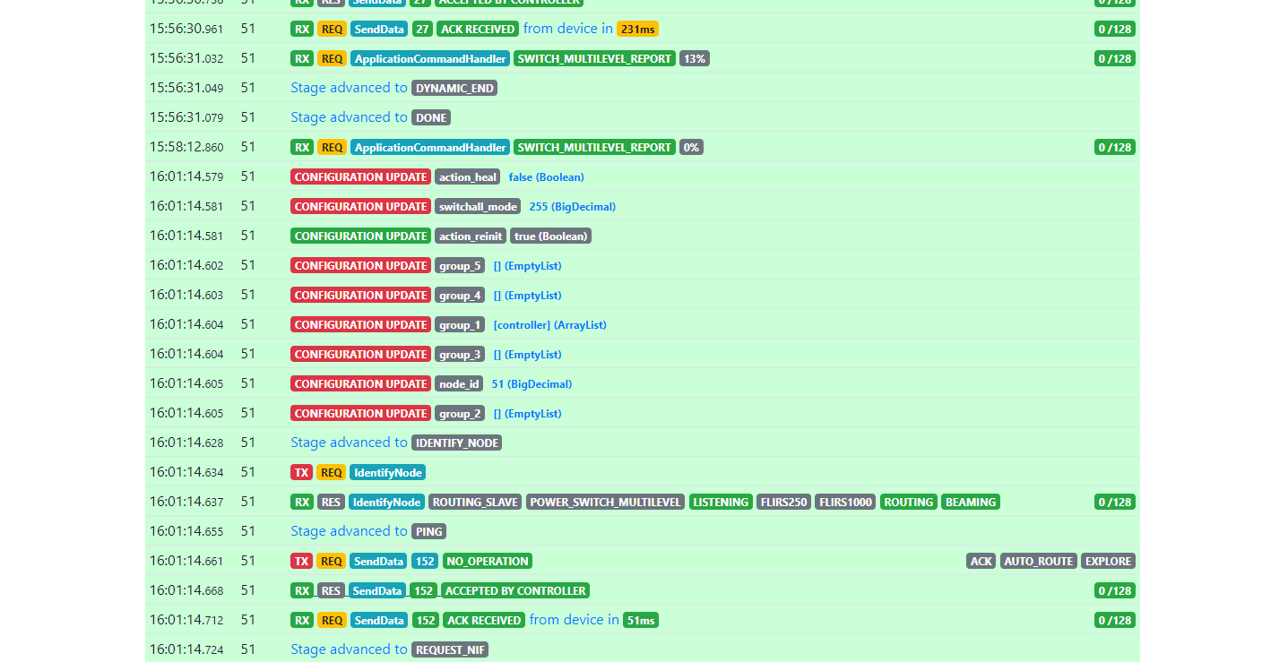

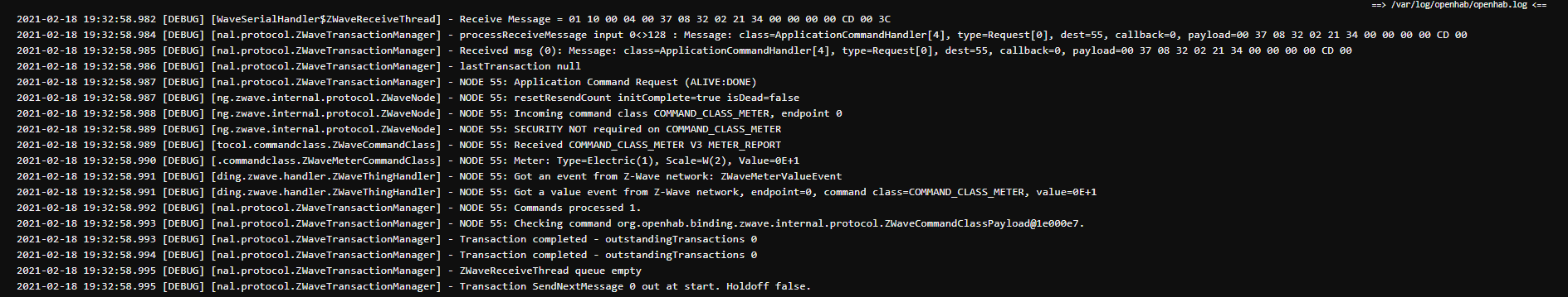

But i really dont know what i am looking for in this debug list. Here’s a snip:
Everything looks to be running correctly after removing it and adding it, but openHAB doesnt recognizes it ? i dont know `?
Tried to re add it , now it has a new NODE ID 53
