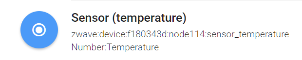

Just added Qubino Flush Dimmer 0-10V (node 115) and Flush 2 Relays (node 114).
I’m getting the temperature reading from Relays OK, but not from the Dimmer.
I have the same problem with the Qubino Flush 0-10v dimmer. (Type ZMNHVD1). I dont get the temperature readings. Thanks for the tip about including the device! Had a struggle including this.

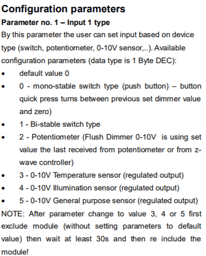

I see that it possible to configure the I1 input as an 0- 10v input. I would really like to have an channel for this. Then I could attach an DP transmitter and regulate the fan.
Could the channel vi see, Sensor (General) be the I1 input, and that the Sensor(Temperature) is the one missing?
I find it a bit clumsy that in order to change Param1 or re-attaching a TS, the device needs to be excluded and re-included. Eats away a node number on the controller …

I will try to change the input type and exclude/include it. Is it not possibly to remove unused nodes with zensys tools and reuse them?

Makes sense, since the manual said the TS has to be connected at include time. Original database contributor probably didn’t have one connected. It is an extra purchase.
I have set the input to General sensor, and the sensor_general channel is working as an 0-10 input. Which is good, if the temperature channel is added. I have connected the output to the input for testing.

@chris, forgive me if I’m wrong, but I was under the impression that the sensor_general channel was working as it should for the I1 and parameter 1, and that the sensor_temperature was the one missing.
If I read this correctly you have now replaced the one with the other?
The sensor_general was I1 that can be configured by parameter 1 Doc.
The reason why the sensor_temperature was missing, I belive was due to the fact that it only shows up if an actual sensor is connected at include time. Since this is a separate purchase, the original database contributor most likely didn’t have one. The xml file I supplies in my first post, had one connected.
