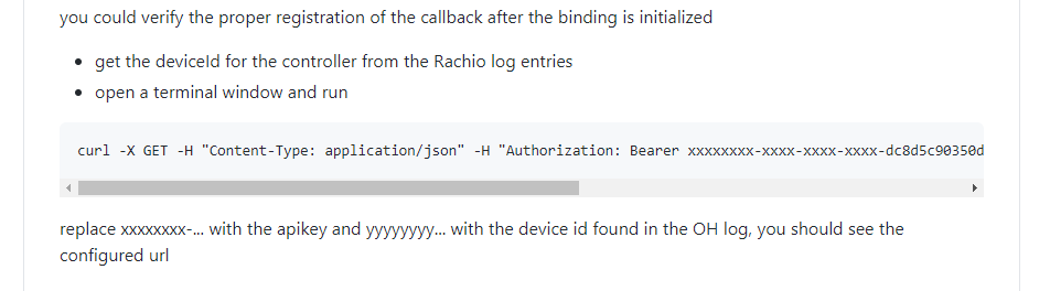

I’ve just stated on getting this binding running, but I’m afraid I’ve run into a roadblock after getting the proxy running (I’ve verified the external connection and running on http with https redirect support). Can anyone tell me where to find deviceid
From the docs:
root@odroid:/opt/openhab2/userdata/logs# grep -E 'rachio.*device' openhab.log

Can’t seem to find any reference to deviceid anywhere.

    • I don’t understand the instruction “open URL http://:/rachio/webhook”. Does the “//:/” part refer to my web domain? In any event “http://pisabell.ca/rachio/webhook” is getting no response.
    • “get the deviceId for the controller from the Rachio log entries”: Is the relevant device ID present in lines such as the following?
